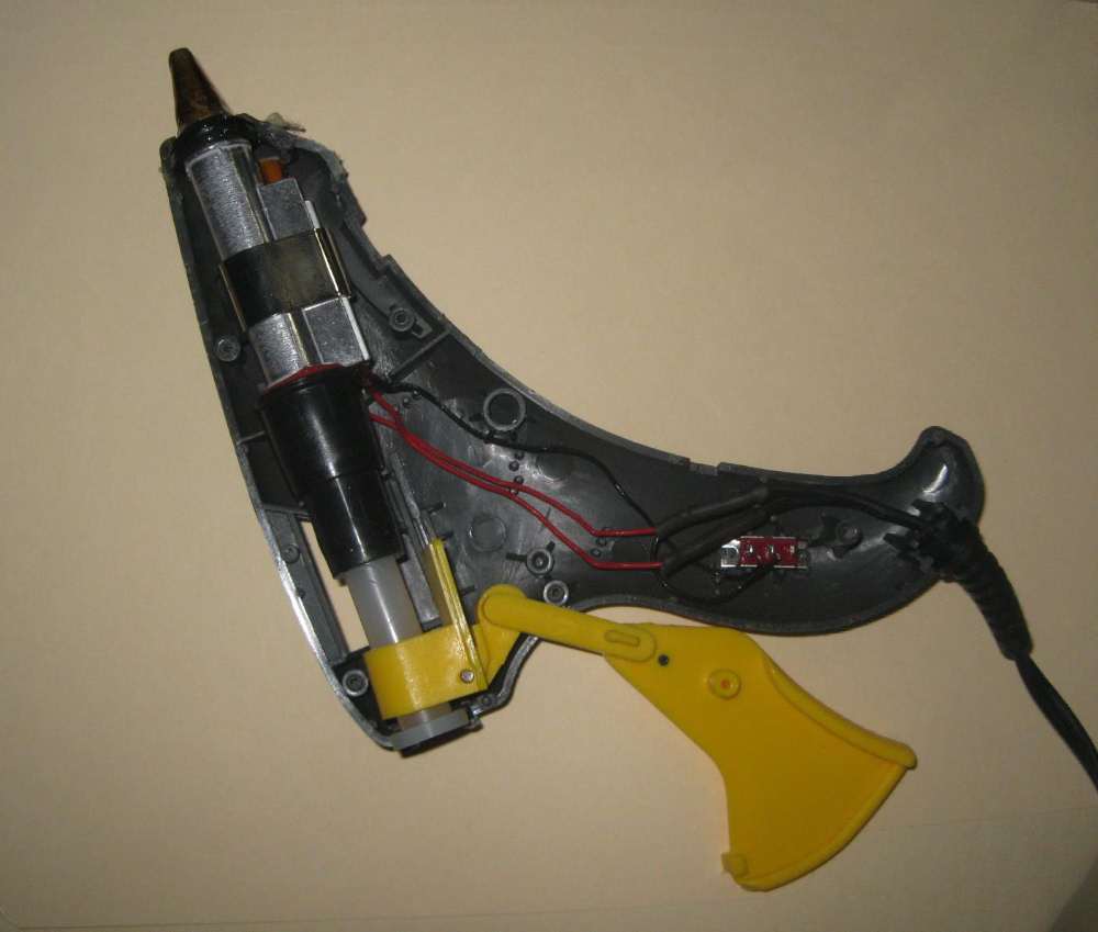

Hello,

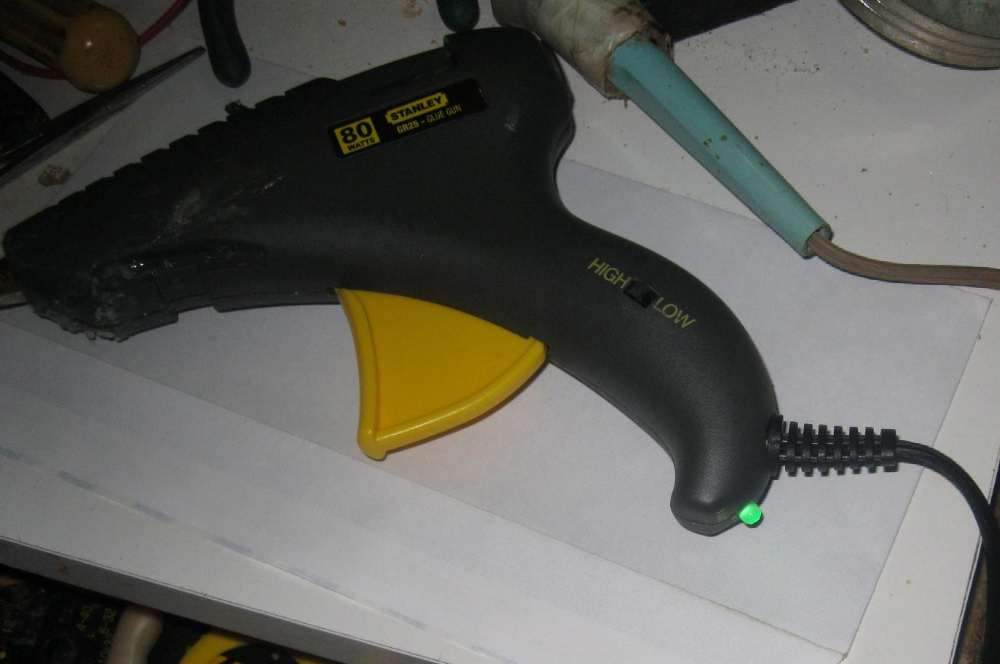

Mine is 40 watts and somewhat new. It was advertized as 80 watts and very fast warm up, but it is 40 watts made by Stanley.
The heater inside is a dual coil for low and high settings, and i think it is partly inductance so probably should not be run on DC.
The two windings will act as a very light duty transformer, but i am not sure if it actually has a magnetic core or just a coil as i can not see inside the coil construction.

I have only ever owned 1 glue gun, a Bostik Handy or something like that, Blue in colour with orange trigger and silicone rubber inserts. It is rated at 45 watts allegedly. It heats rapidly, in fact, it continues to do so, until the glue is really too hot and begins running out of the nozzle on its own. This excess heat eventually melts the remaining glue stick still protruding from the feed side of the chamber, which of course then drips into the trigger mechanism gumming it up. I have taken it apart several times to clean up said trigger, and can confirm that the heater and glue chamber are solid diecast alloy of some sort, wrapped up in Kapton tape and plugs directly into the 240V mains. It must be going on 18 years old and still works well considering I only paid about £10 for it new :)

As far as I remember, when they first came out (and I still have a pre-trigger early Bostik one) it was said that 'new technology' had made them possible. Essentially a self-regulating heating element - so no thermostat.
So not really 'repairable', as it's just an element and a casing.
I have a couple, and the silly blurb on the side of one I translate to it having a ptc heater, the heater element also being a thermistor, when cold the resistance is low making it pull more power, then when warm the resistance is higher making it pull less current, making the element sort of self regulating.

tunedwolf, if it has a switch and just a simple element consider soldering a diode across it and see if you then have a low/high heat gun.
If it does use a transformer then this is not a good idea.

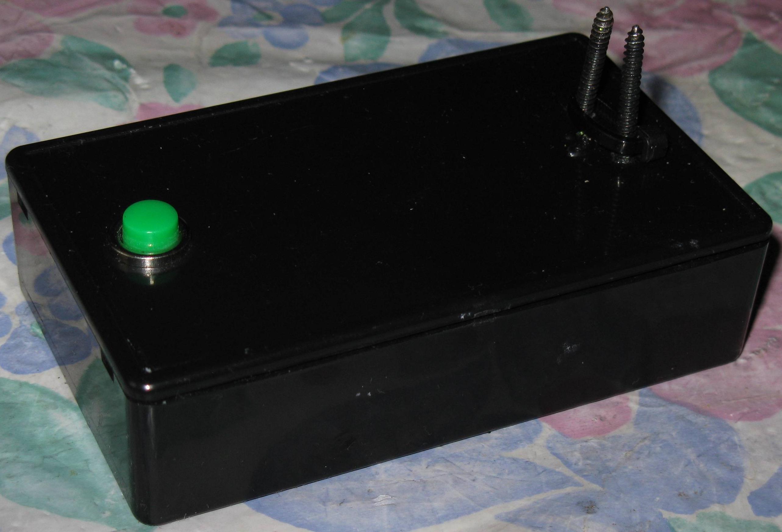

I built a high voltage arc-er. The voltage jumps about 8mm. To get it to jump at the thread end of two screws consistently and not at the screw head end I put a barrier of hot glue between the screws. This was effective.
The voltage is somewhere between 20,000 volts and maybe a few hundred thousand volts. Driven by two AAA batteries.
