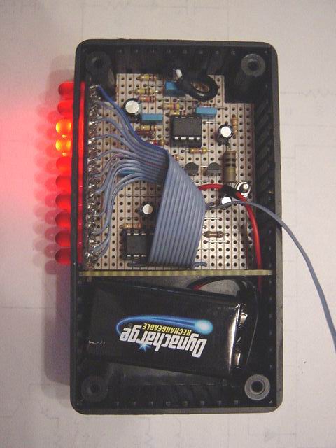

I made a Sound Level Indicator project. It has 10 LEDs (actually 20 but 10 groups of 2 in series). It can indicate the sound of a pin dropped on the floor in the next room. Its first LED lights if the furnace or fridge is running and if they are quiet then I must hold my breath for no display. It has a range of 50dB so it also indicates loud sounds.
You must determine how much sound level is needed for your application.
Tiny button batteries can light an LED dimly for maybe 30 seconds. Then they are dead.

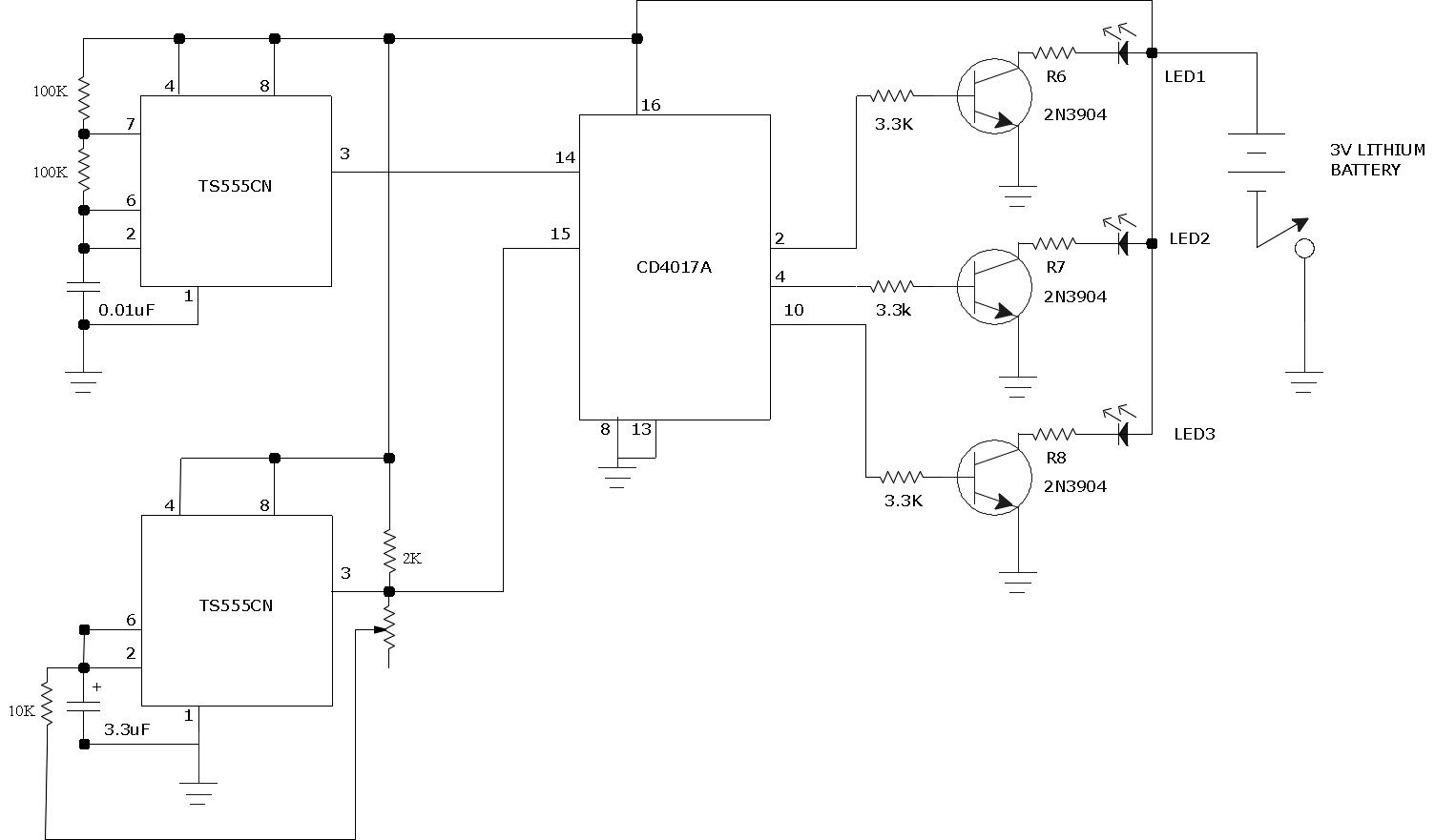

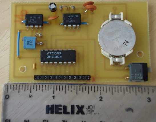

With a couple of A76 alkaline batteries, a cmos 555, a low voltage op amp such as TS972, and a few parts a circuit could be built.
The thumb nails of a haloween badge I made over a year ago is shown.
The whole circuit runs of a CR2032 coin size lithium battery. The Boo Badge B image is of the battery and the control circuitry. It has 2 cmos 555 timers and a 4017 counter. The other board has some 2N3904 drivers and believe it or not each letter has 4 or more LED's in parallel. The letters actually flash on and off and they are charlie plexed. One timer feeds the clock input of the 4017, and the other drives the reset line. The same battery has power the badge for about 8 hours in the past two haloweens.

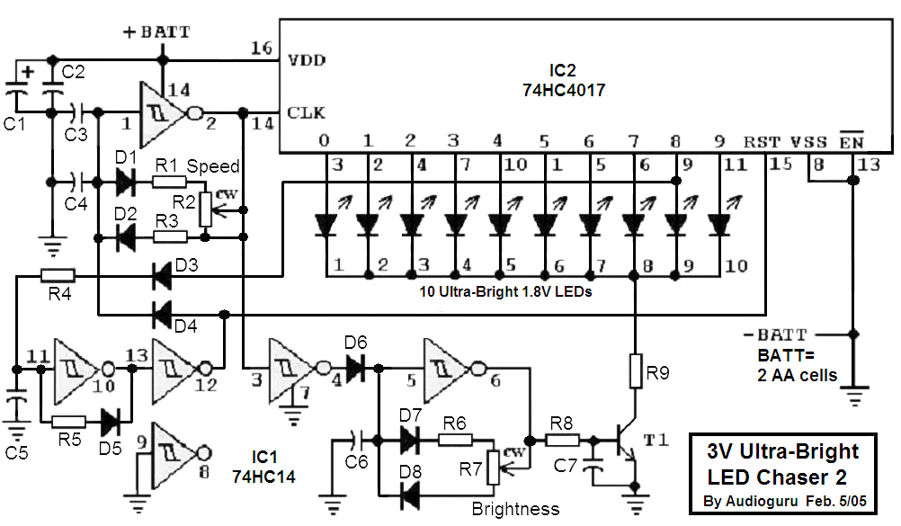

I made a 3V Ultra-Bright Chaser project using high-speed Cmos ICs and the LEDs chased around and around and around ... no-hum very boring.
Then I made a 6V one using very bright 3.2V green and blue LEDs and made the LEDs chase around a few times and stop for a pause. Then chase around again then stop for another pause.
Then I converted the 6V circuit to 3V.
The circuits have a speed control and a brightness control. The brightness is done with PWM. The battery lasts for a very long time.

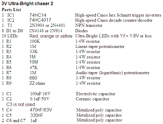

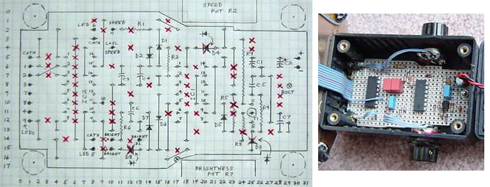

Here is the parts list and Veroboard layout for my 3V Chaser-2.
