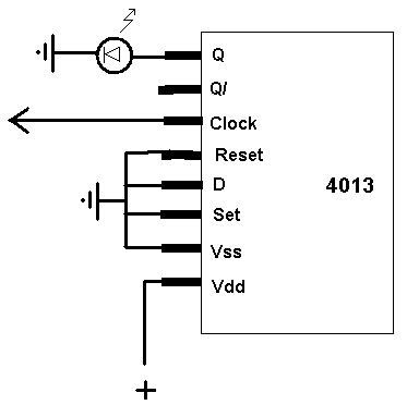

I know this thing should be simple, but I just can't get it to do what I want or expect it to do.
I want to use a signal to trigger a latch, and that latch stay set until I use a different signal to open it, regardless of how the trigger signal changes. Should be simple.
Using a 4013 I came up with the circuit attached. However not only doesn't it do what I want, it doesn't do anything! :( I expected it to turn on the LED on the first pulse from Clock and the LED to stay on until power is interupted from Vdd.
So throw me a bone. What the heck am I doing wrong? I'm obviously missing something fundamental about this IC.
Thanks.
-Mark

The circuit doesn't work to your expectations because you have connected "D" pin to ground. Remember, in a D Flip-Flop, whatever data is there on the "D" pin will be transferred to "Q" pin (output) on every clock pulse. Here "D" is at logic 0 so your LED doesn't lit up. Make "D" = 1 and then try giving clock pulse. It will glow.

it sounds like what you really want is an R/S flip flop... that way you use one line to turn it ON, and the other line to turn it OFF, rather than interrupting the power to turn it off...
also, yes, with D tied to ground, Q will always be 0... you could switch your LED to Q/ or pull D high.

Just a note. The previous circuit works fine as long as the trigger signal isn't present when reset is applied. My datasheet shows the 4013 driving both Q and Q' high if both SET and RESET are high at the same time.
Keep in mind that the asynchronous inputs (SET & RESET) take precedence over synchronous inputs (the "D" input in this case. Synchronous inputs are those that change the flip-flops' state on a clock edge.) If you want to reset the flip-flop regardless of the state of the trigger input, use the D input (set to a logic one) & clock to set, and the RESET input to clear.

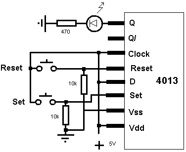

Sorry guys but it's still not working. Connected as drawn above it doesn't stay on once the trigger signal is removed. :?: What could I be doing wrong?

D flip-flop connections
"Connected as drawn above"
refers to which schematic or suggestion? Could you post a schematic of your current hookup or list what each pin is connected to? Does the trigger signal go away before the reset signal is applied? Sebi's right, the flip-flop will behave like a latch if the asynchronous SET and RESET inputs are used, they just shouldn't be driven at the same time, as noted earlier.

Re: D flip-flop connections
I tried Sebi's drawing. Since I don't have another 4013 I tried the other side with no improvment in results. Currently, both Q and Q/ stay hot all the time no matter what I do to Set and Reset (although at about half the supply voltage).
What should the set and reset be connected to when not "in use"? Can they just float?
Just to paraphrase my needs, I want the light to come on and stay on. To turn it off I will probably just remove power from the whole circuit, so that simplifies some things.
Thanks again folks.
CMOS inputs
You should never leave CMOS inputs floating, tie unused ones to their inactive level. For example, the set and reset inputs should be tied low when not in use. Your 4013 may be damaged (first make sure that you've tied all of the unused inputs inactive). What other ICs do you have? It's easy to make a cross-coupled latch out of a couple NAND or NOR gates (CD4011 or CD4001).
