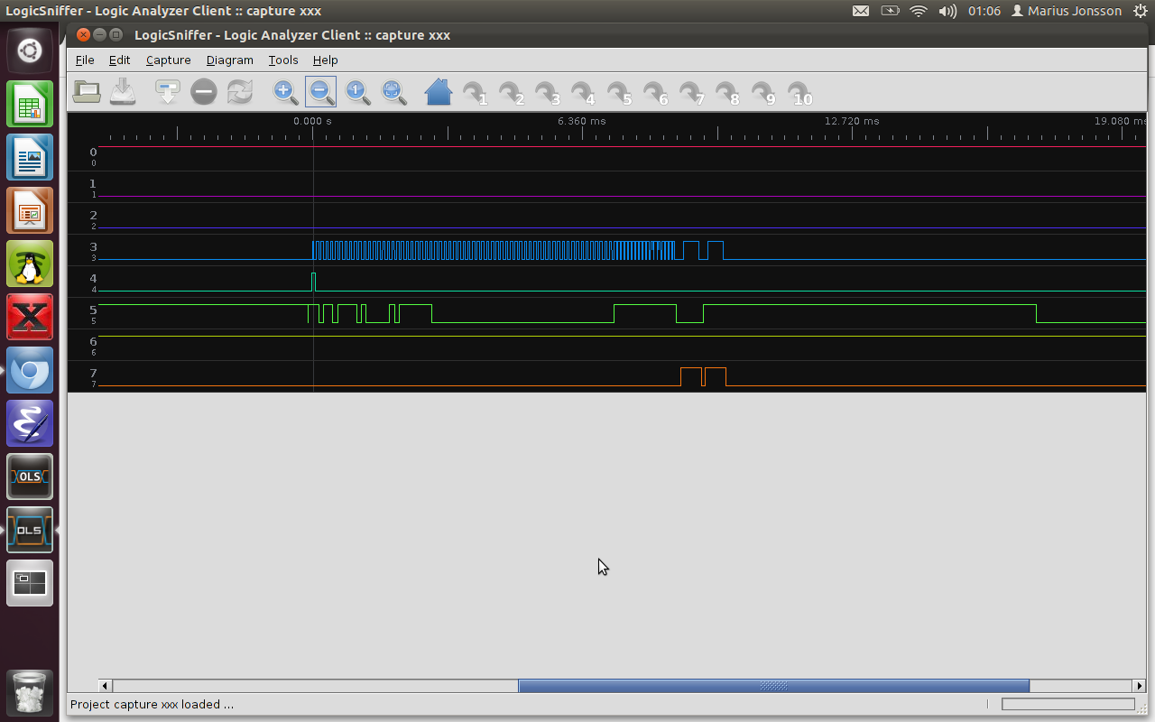

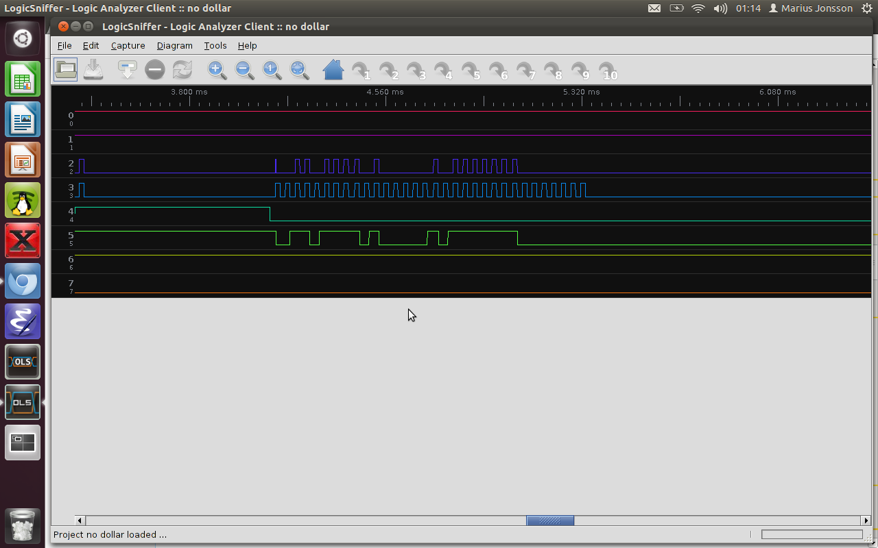

I captured this data, how do I determine which protocol it is?
king.oslo
Hello there,
Please see the attached screenshot.
How do I determine which protocol the I captured here?
Frequency of the clock is circa 25kHz. According to my calculations, it is 26227Hz.
Thanks.

Maybe if you could tell us what device you captured it from it might give a better clue. Better still, what chip was it at the input or output of?
Does not look like any special kind of protocol to me, just control signals for some kind of shift-and-load device, like 74HCT595 shift register chain, or graphic display maybe.
Trace 4 looks like a reset signal.
All just guesses with the minimum information provided.

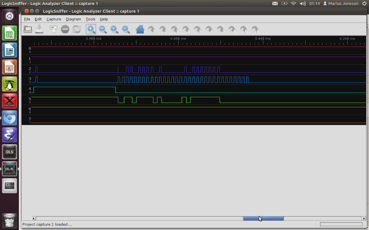

Trace 3 appears to be a clock... one that changes duty cycle and frequency, very strange. Traces 4 and 7 appear to be start and stop signals.
Trace 5 appears to be data. From the asymmetric high and low periods and the multiple clock pulses, it would appear to be some sort of NRZ format - like Differential Manchester encoding.
When the card is inserted into the reader, the reader displays the value. I reckon it is probably transferred to the reader through the contacts (The reader does not have a phone line).

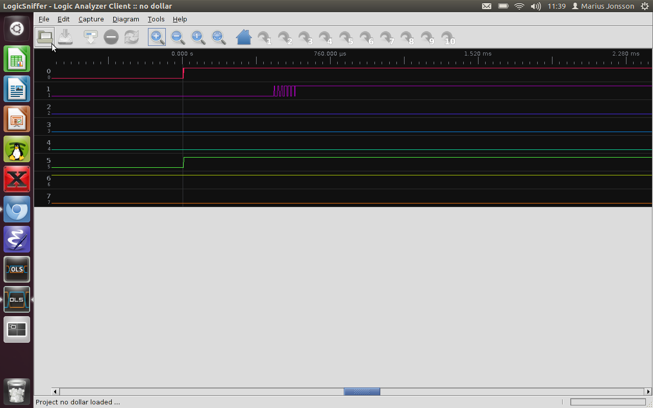

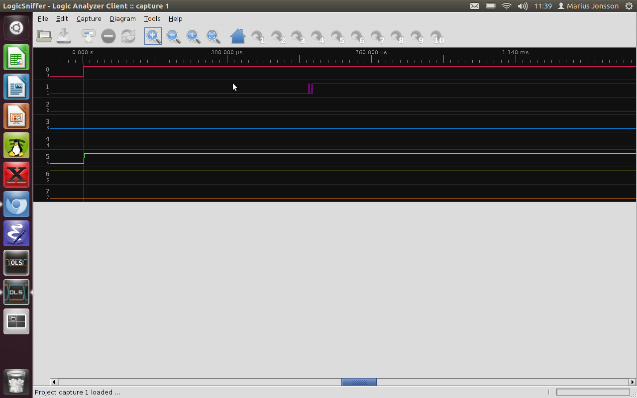

This is the communication when the balance is ten and balance zero. Strangely, they look pretty much identical (the first attachment is for 10 credit balance, the second is for no credit balance)
The only difference is in trace 2 at the very beginning of the signal (the third attachment is when there are no credits on the card. The last attachment is with 10 credit balance).
What do you think?
Thanks.M
The first two certainly do look identical. Are you certain the card is being queried for the number of credits in this transmission? Simply reading the card may not be enough to do it, and if there are multiple transmissions the logic analyzer may only be grabbing the first.
Concerning those last two images: the violet trace on "no credits" looks more like an increasing PWM than data. For a chip that is powered by the reader, this may simply be an ordinary power-up glitch. Try reloading the "no credits" card with 10 credits and see how it compares.
