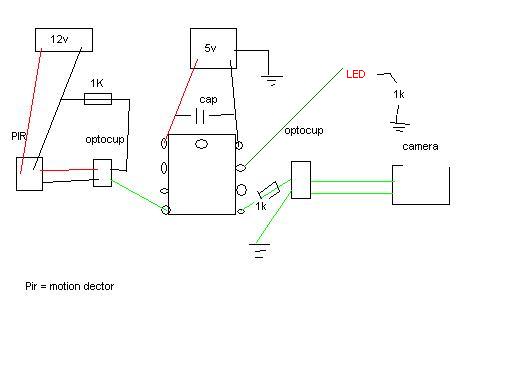

I finaly program my first working PIC chip 12f629
But it is geting somekind random in put on the input pin unless i use a reastior on the pin! ( tied to postive )
I was Trying to use a little parts as possible
Must i tie all unused pins to ground like a CMOS chip?

Some PICs have "week pull ups" these can be enabled normally in the option register.
Un-used pins can be left to float, enless you have enabled MCLR (in the configuration word) if its enabled, that pin must be driven high.

You can set all unused pins as outputs, that avoids any problems. If the pin you're using as an input is having problems, you will need to do 'something' with it - what are you trying to connect to it?, how about posting a piece of the circuit.
Circut
Here it is
I'm not suprised it doesn't work, I don't understand the left hand one at all?, and the right hand one hasn't got any pull-up to enable it to work.
You only need one resistor for each pin as a pull-up, fed directly from the output of the opto-coupler. When the opto-coupler is on, the pin will be low, when it's off the pin will be high - you write your program accordingly.
