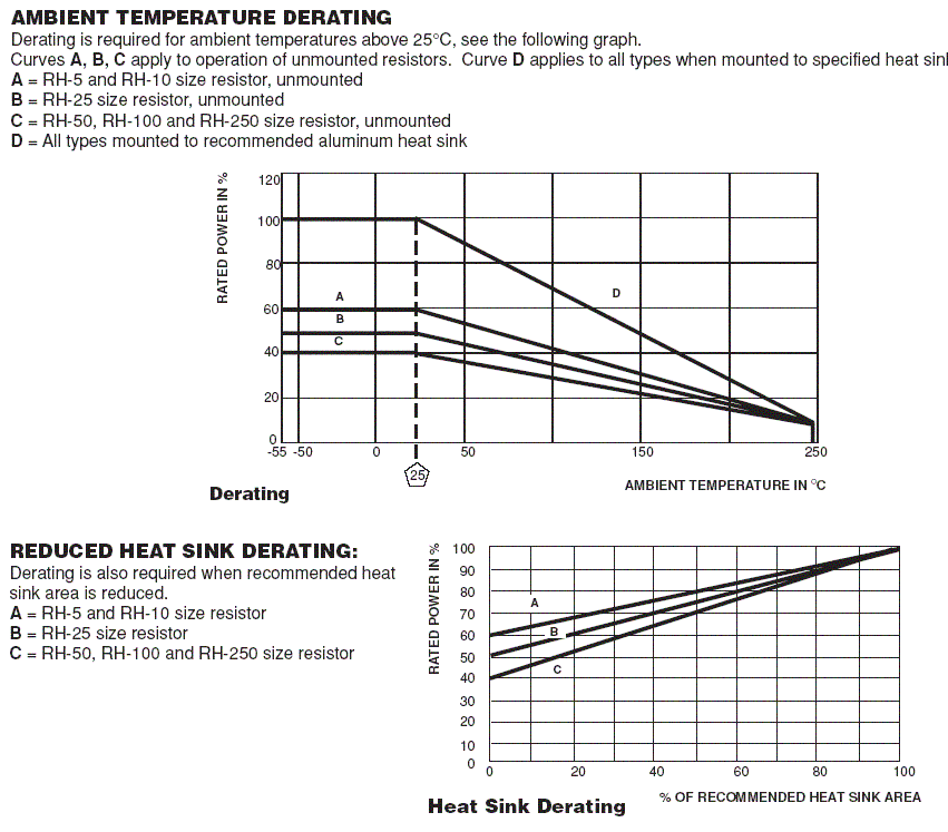

Wallins indicates that the 20 w resistor should be non-inductive. Substituting with common wirewound power resistors may add a bit of inductance. At audio frequencies the effect may be trivial though in a test fixture you may want to limit any sources of potential error.
Just to satisfy my curiosity I wanted to see what impact a small amount of inductance might have. I looked at a table and saw that a 5/8" diameter coil (air) with 10 TPI has an inductance of 1.7 microhenries. That might represent the inductance in a 50 w resistor. I also thought that if the inductive reactance were 10% of the resistor value that might be significant given that it is a test fixture - that's 0.8 ohms. At 10 kHz you'd need an inductor with about 13 microhenries to get 0.8 ohms. All of this presumes that my hurry-up math is correct. Where I come out in all this is that using a wirewound resistor may impact things so be ware. The result would be a load that changes slightly with frequency.
That should do perfectly...
It's non-inductive (NH) and according to the graphic's it should be able to take care of 20W without heatsink...
Take a closer look at the power derating graph. The vertical axis is percent of rated power, not watts. The NH50 is rated at 40% (20 watts) with no heatsink to 25C, and goes downhill above that temperature. I would mount it on something that can radiate a little more heat.
