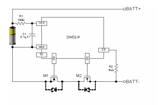

It's quite a common configuration when a "switch" is needed that can block current flow from either direction.
MOSFETs often have a "reverse" diode, either due to the basic structure of the transistor, or deliberately to bypass any reverse current and avoid damage to the device - such as regeneration current in an H-Bridge power controller.
Because of that diode effect, it's best to use two, with opposite connections, to block both polarities or current flow directions.
Some systems control both together, some control them separately, such as some lithium cell protection circuits; this example shows the internal diodes, making it a bit clearer why both devices are required:

MOSFETs often have a "reverse" diode, either due to the basic structure of the transistor, or deliberately to bypass any reverse current and avoid damage to the device - such as regeneration current in an H-Bridge power controller.Because of that diode effect, it's best to use two, with opposite connections, to block both polarities or current flow directions.Some systems control both together, some control them separately, such as some lithium cell protection circuits; this example shows the internal diodes, making it a bit clearer why both devices are required.
The substrate diode is intrinsic to all MOSFETs.
It can't be avoided (see N-MOSFET basic structure below).
Since the substrate cannot be left floating, the source terminal is normally internally connected to the substrate, thus giving a forward-biased source-drain diode if the source becomes more positive than the drain.
The exception is for a few commercial MOSFETs that connect the substrate to a fourth external terminal.
