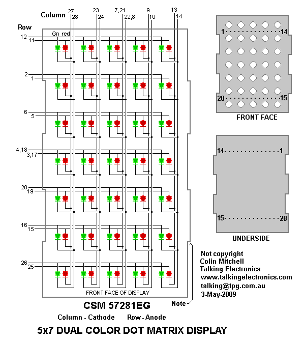

AtomSoft . . . . Have you notice the pin-out for the 5x7 display you are advertising does not correspond to that in the .pdf
I have redrawn the pin-out diagram correctly:
You can use the image.
I also sent a copy to BG Micro but they did not have the intelligence to reply.
They also sell the displays for about $1.50 each
i got it from them but i had bought like 20 so discounted lol
EDIT:
THANKS!
EDIT2:
Is now updated with new info...
