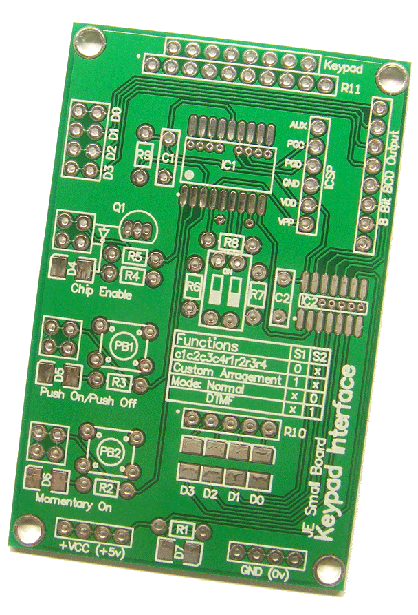

I had a PCB professionally produced, Take a look
I think im in the right forum now...
After doing a couple of PCB designs for a mate I was eager to design my own.
I came up with the idea for circuit that converts a decimal/hexadecimal number from a matrix keypad to a binary number .
This is basically what the PCB does.
By using a 74HC164 shift register, It is possible to get 8 bits/a byte of data from the outputs lines.
It also has push-on push-off outputs and momentary on outputs.
It comes in handy for things like manually testing LCD's or chips that require an SPI interface.
It is shown assembled on my new site and there is also a YouTube Video: http://jakeselectronics.x10hosting.com
Or click the attached file to see the PCB...
Very nice.
It's always cool to get your first board back from a board house.
Hehe. Arragement.
Nice attractive and well laid-out board. :)
About the only thing I can fault is that with the 0.1uF decoupling cap on the 16F628A I would have made it closer to the PIC Vdd and Vss pins with much thicker tracks. And maybe the 8 vias under the PIC, they are too close and possibly might short. I would have made them staggered or put some outside the PIC.
You could also have used solder mask over the vias which again reduces chances of shorting but that's a personal preference. Also I'm not sure about all those little orphans under IC2.
But all in all it's very nice. Congrats. :)
Based on the other post, it looks like he had this made by Futurelec, so options for things like masking the vias is pretty limited if not non-existant.
Futurelec is a non-option for me, since their minimum 10mil trace/space rule means every chip with a popular 0.5mm lead spacing is unworkable.
It also seems pretty expensive. I just priced a single DS 10cm x 10cm board and was quoted $71 USD. 10 would be $161 USD. For $100.00 USD you can get 1000 square cm of DS with solder mask and silkscreen at Gold Phoenix and 7mil trace/spacing, shipped.

Here in australia I had a quote and it was about 3 times the price futurlec did it for. The quality would have been better, but 3 times the price just wasnt tempting.
A bit more research in the production stage couldn't have hurt, but I was too eager.
That will teach me.
Overall the quality is pretty good. The silkscreen could had been alot crisper, but NOW i know.
Maybe ill try Gold Phoenix next time.
Thanks for the tip.

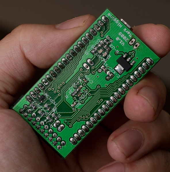

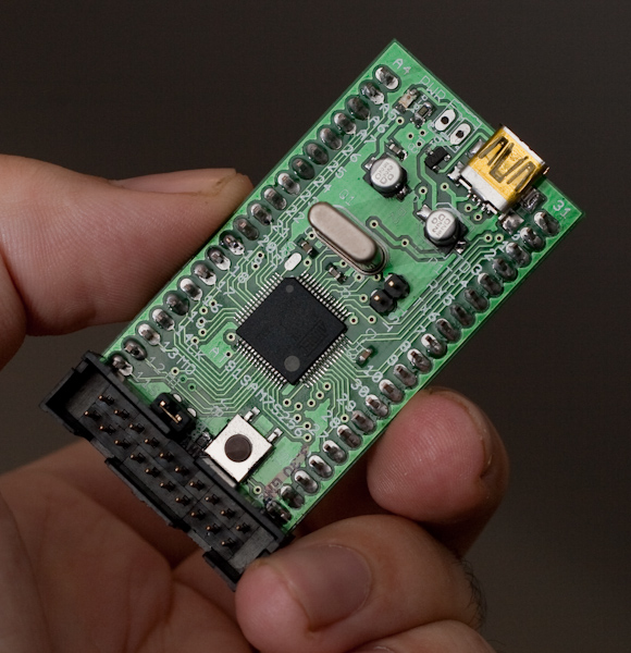

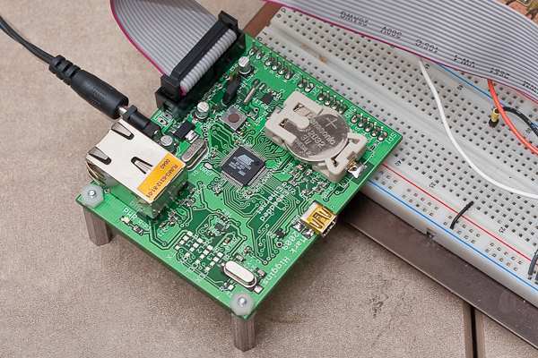

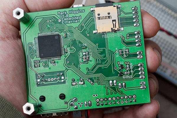

I'm sure I've posted these before, but these are SAM7 development boards I had made up. I etch my own boards and I don't sell anything, so I don't have much of a call for a boardhouse, but the ARM7 chips are just too complex around the chip with the seperate core power and PLL and all the decoupling caps to make anything home etched all that pretty.
Those boards were done by BatchPCB because I just wanted individuals. BatchPCB uses Gold Phoenix for their manufacturing. I got three boards in total, all different designs for $46 shipped to Canada. One board is not shown.
I populated the boards myself. Regular soldering iron.
I'm going to be doing some boards for my RF project here and I'll want a few of them, so I'll likely be going directly to GP for that.

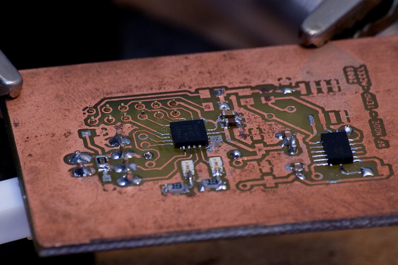

I've been trying out the TI CC2500 and the Microchip PICTail PLUS modules, but I'm working now with the RFM12B. Google 'jeelabs' and he's doing very similar to what I'm doing except I'm using MSP430's. I'll have remotes and nodes for data collecting and remote operation. It'll be working off a fairly simple P2P network that I'm just adding some complexity too. Trying to get the power requirements as low as possible for nodes that need it.
20090930-lcd7110-thru-pcb-001-jpg.33906
20090809-rf-node-photo-002-jpg.34167
Have you tried a toaster oven or electric frypan for the SMD?
It gets really easy once you get used to the preheat/solder time cycle and how much solder paste to use.
Considering how many PCB making threads there are I'm surprised there's not more threads on here about doing SMD reflow soldering. It's easier than making the PCBs...
I keep thinking about a toaster oven, but I can do leaded SMD quickly. For leadless packages like QFN's I have a hot air rework station that works really well.
The Weller portasol PSI-100k and Master Ultratorch UT-100 with hot gas nozzle work well on butane. Less 'wind' to move parts around and hotter output then hot air tools.
Of the two, I like the Master Ultratorch better.
When I have to build more then six copies I get a solder stencil made. Tape down datum boards and use business card to squeege on solder paste. Then on to hot plate.
