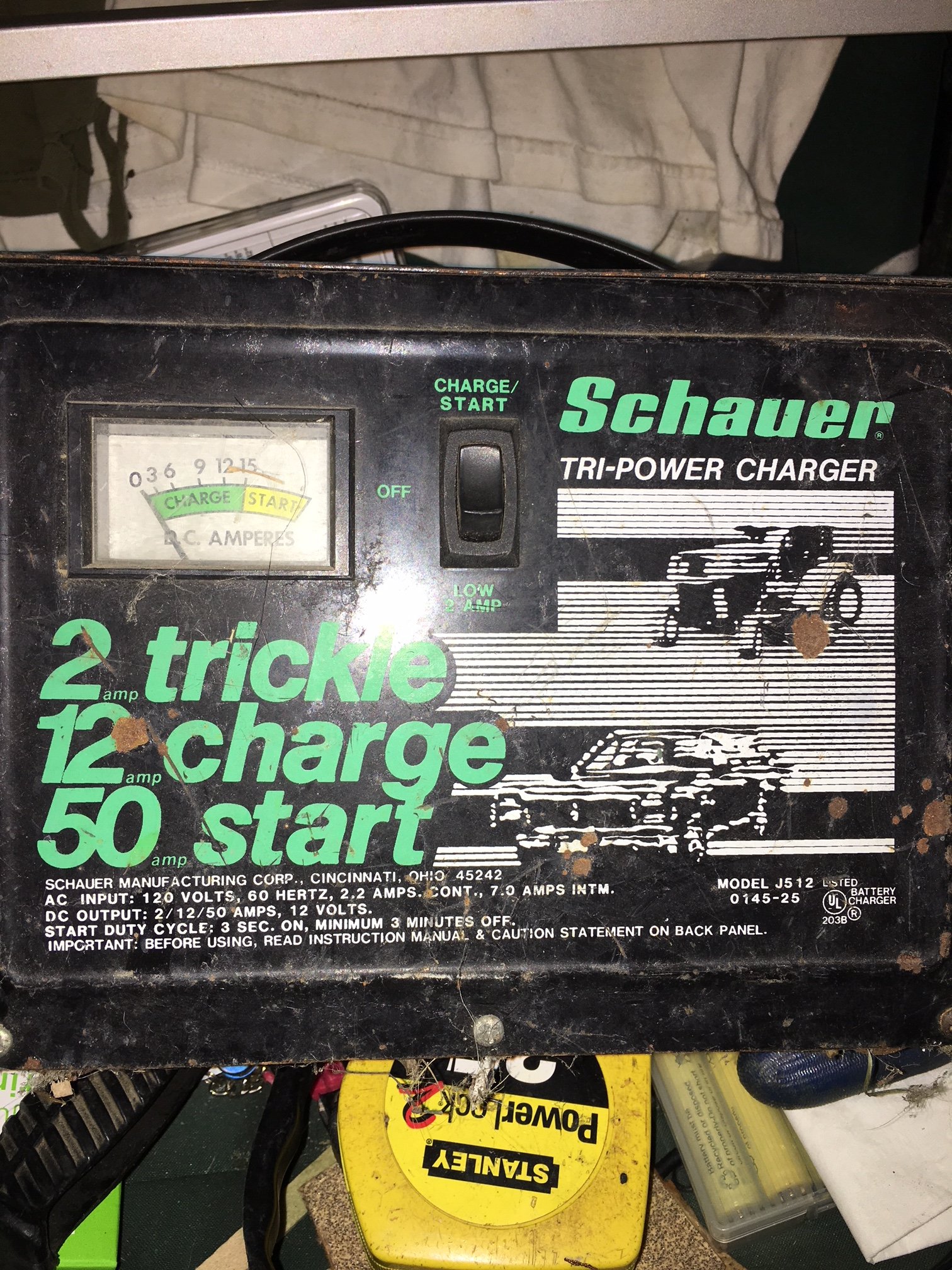

I have a schauer 12v battery charger
exJarhead
The charger is a 2 amp trickle-12 amp charge-50 amp start. DC output is only 11.8 - 12.0 it has a start duty of 3 seconds on , minimum 3 minutes off. but when trying to charge a battery it is on 3 seconds and off maybe a minute and back on again and there is now battery draw at all. I would like to repair it if i can find parts and find out what the problem is. Schauer model#J512 . If i caint find the exact parts maybe the original parts can be replaced with parts that work. Help
I have a 2/12/50 amp car battery charger. when i test the DC output i am getting 11.8 - 12.3v. When i connect to battery to charge it the meter shows about 3amps then it goes to zero and then back to 3amps and it does that for a while till it stops all together and i have to unplug it for a long period of time before it resets

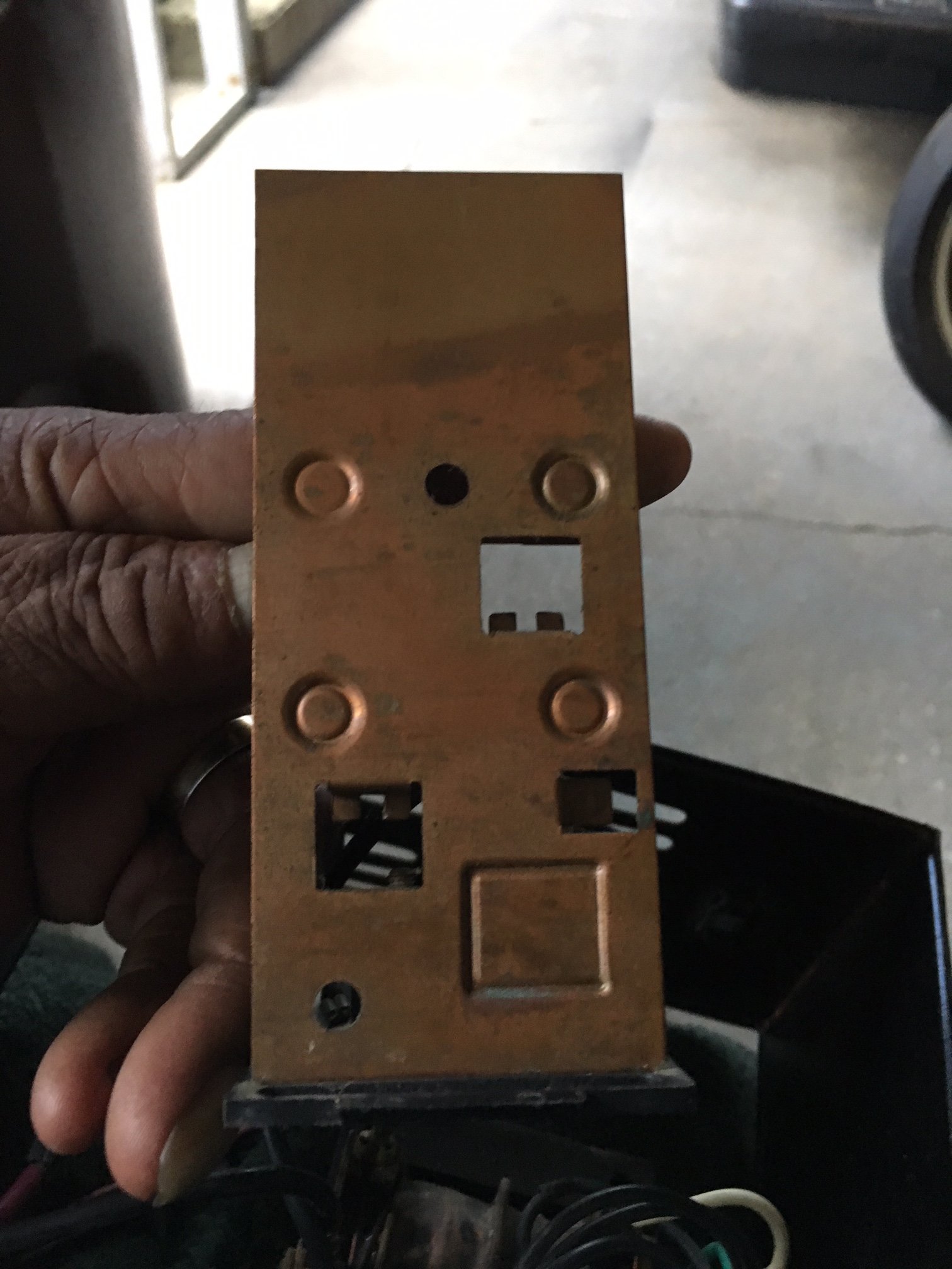

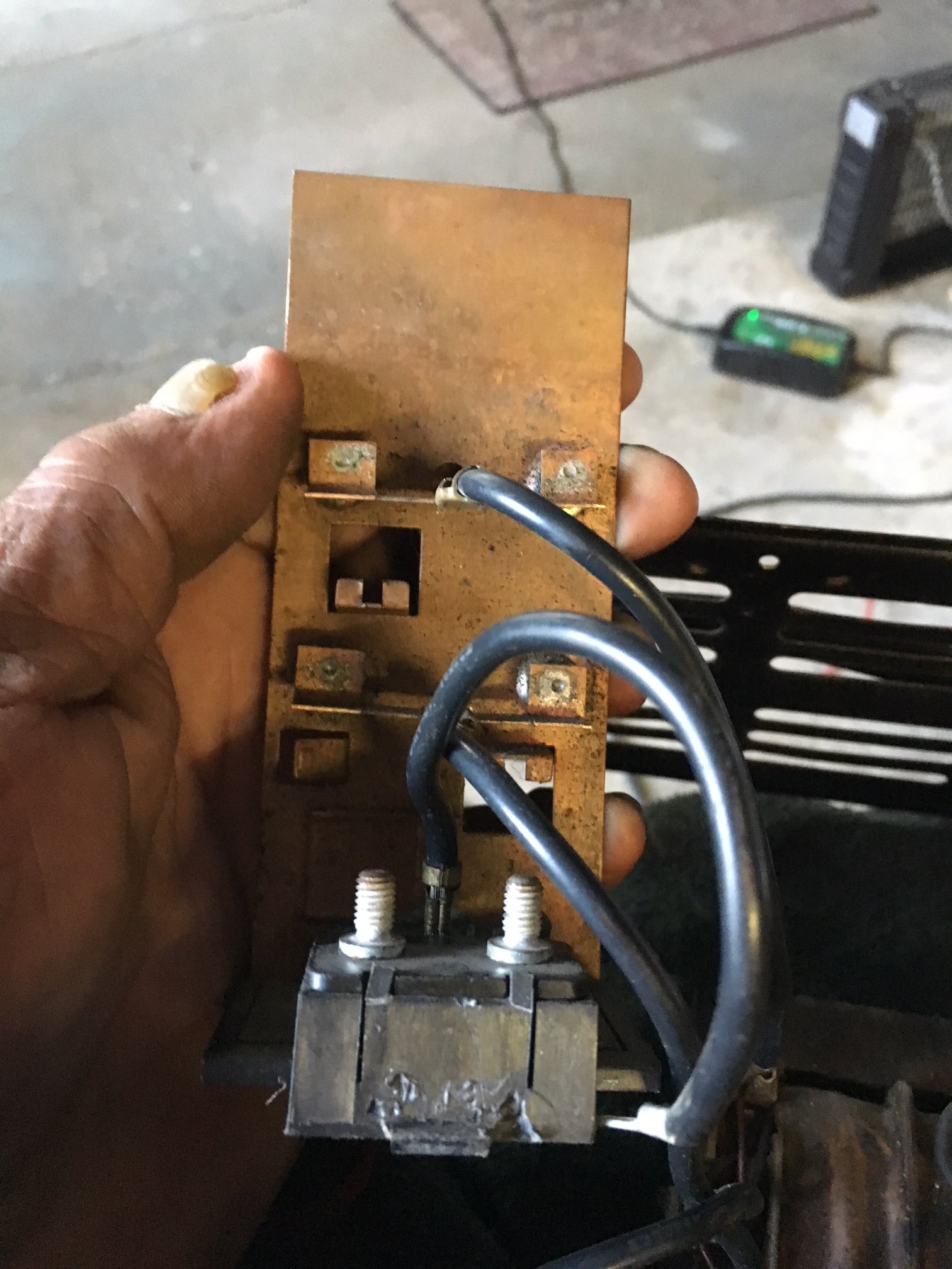

What i would like help with is troubleshooting this unit and doing a repair. But i am not sure where to start. There are no numbers on the transformer or the copper plate the diodes are mounted in or on the diodes.
These are some pictures for reference.
