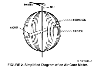

I would like to create an air core meter that is driven by using a PIC.
There will actually be two air cores, one for speed, and one for revs.
The revs will be from a pickup from the gearbox, speed will probably be via GPS.
The final product will also have a LCD display for odometer, a digital clock (may be separate smaller lcd) and I'm thinking cabin temperature.
This end product is something that I want to use in my Merc 1729 horse.
I want to use a PIC 16Fxxx, but am worried that it will not keep up.
Has anyone ever experimented with driving air core meters?

Let's put it that way, if you drive a recent vehicle, there is a chance that your speedo and/or rev counter needles are controlled by an air core.
Real nifty device, rather simple, very few mechanical parts, low failure rate.
I had to look up what an air core meter is, since I never hear of one, but in my search I came across this.
You may have already found this, but just in case you have not I posted the link. It looks like an air core driver IC.

I'm starting with the air core meter, and I am currently scouting for suitable copper wire and a suitable magnet. I think I might get my required 130 degrees with a 5 volt shunt on both coils, so I might pass the commercial air core drivers, and drive them using the PIC with a bit of electronics.
You barely need any amps.

At least I have procured my thin copper wire for the sine and cosine coils and seems the magnet as well, it should not cost me too much either.
