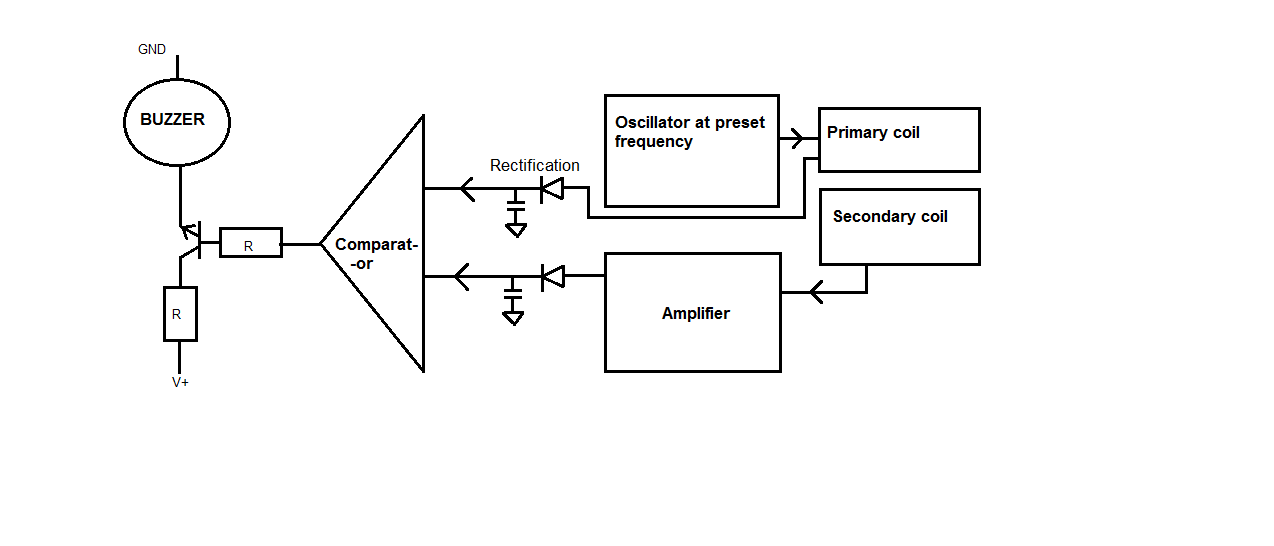

Here i am posting the block Diagram of metal detector circuit.
the primary coil will generate an alternating magnetic field which will strike metal and produce eddy currents in metal, these eddy current will generate its own magnetic field in opposition to main magnetic field and will be picked up by secondary coil.
Secondary signal will be amplified and rectified to be compared from main signal.
comparator will be normal op amp which will amplify the diffence in both the signal.
this signal will then switch ON the transistor which is connected to Buzzer. if signal is strong enough then only will transistor switch ON, this will be determined by base reistance which is variable resistance.
Do you think this circuit will work ?

The main problem is going to be eliminating cross-coupling of energy directly from the Tx coil to the Rx coil. Any such cross-coupled energy is likely to be vastly greater than the eddy current energy you are trying to detect. So your signal will be swamped by noise.
Do you want to come up with your own circuit, or do you need to make a metal detector circuit somehow? If the case is the later, read about BFO (Beat frequency oscillation). It is the easiest method to build a metal detector. You will be feeding two frequencies(from oscillator circuits) into a frequency mixer chip. You can set the mixer to give you the difference in frequency as an output. This difference will then be amplified and fed into a speaker. You will have two coils of course, one in each of the two oscillators. One coil will be your detector coil, when it comes in proximity with metals, its inductance will change causing the the frequency to change in one of the oscillators, which is turn, will generate a difference frequency you can amplify and hear. Of course you will have to design your two oscillators to have the exact same frequency at the initial condition.

its pretty basic BFO but would it be good enough for an industrial grade metal detector ?
oh i didnt thought about that !
ok if i filter out the cross coupled frequency out from receiver coil then amplify the detected signal it should solve the problem.
But again would freq. of detected signal be different from transmitt freq. or would the phase differ ?
IMHO the detected signal is likely to contain various frequencies, including the transmitted frequency and its harmonics, plus local resonant frequencies induced in objects by the transmitted energy. I'm sure there are experts on websites devoted to metal detectors who would better be able to advise you.

i made a AND gate comparator to detect a magnetic field. but i have now a bigger problem.
How do i stop cross coupling between two coils ? as alec_T has questioned me in post #2
