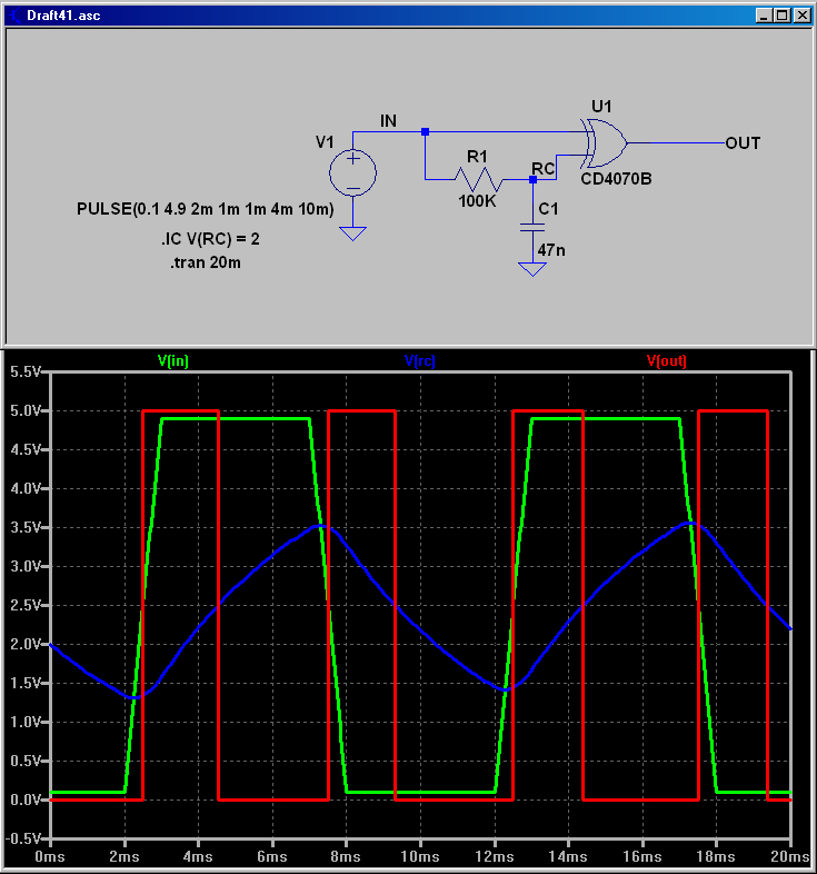

I need a diagram for a circuit to make a 4cyl engine tachometer read correct on 1cyl
circuitman1989
I know I've asked this before but I am still not able to figure this one out. I have a 1973 8hp briggs and stratton lawn tractor engine with the old mechanical points and condencer. the factory magnito was broken and after comparing prices I found out it was cheaper to go buy a new stock chevy style 12v coil and ballist resister plus then I got a higher voltage spark which means a cleaner burn of the air/fuel mix and a better running engine. but my problem is now the engine wants to run a higher rpm than the factory maxium rpm's so I want to hook up a tachometer, but all the automotive tachometers in my price range only work with 4, 6, and 8cyl engines. So I need a circuit to make the tachometer think the one spark per one full rotation output of the engine is acutally 4 sparks per one full rotation.
Can any one help me by making a diagram for a circuit that will work for my needs, Please?

Two edge-triggered D-FlipFlops wired as a Johnson counter to divide by four should do it.
You will need the circuit I posted to this thread to make a clock for the flip-flops.
Mike, he needs to multiply, not divide.
However, all the Briggs and Stratton engines that I have seen are timed from the crankshaft, so you get a spark per revolution, not one for every other revolution. That means that the rev counter for a 4 cylinder engine will read half what it should when connected to the B&S engine.
Ok, then you use the posted circuit in the other thread as a clock, feed it to one input of an EXOR gate. Delay the clock using an RC, and feed that to the other input of the EXOR. That will cause it to output a pulse train at 2X the rate...
