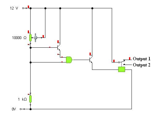

What i need is a switch circuit drives a 12v relay at exactly 3 volts or more.
i mean a small simple circuit that closes the 12v relay when the input signal voltage of the circuit reaches 3 volt and opens the relay again if the signal runs below the 3v , and that circuit operates at 12v.

this as a base circuit should work, you might just need to change a few values of components in there, if you wish to get the 3v/12v exact change

thanx , i had seen the circuit , but i can't understand anything .
The cicuit i need is not to switch between 3v and 12v , it runs on 12v , and the input signal is 3v max. so when the input reaches 3v or more the circuit output closes the relay.

i must have phrased mine wrong. unless i have missed something drastic in my diagram, i think that is exactly what youre looking for
The cct switch on about 3.2-3.4V input. If You need higher precision, use a comparator.
