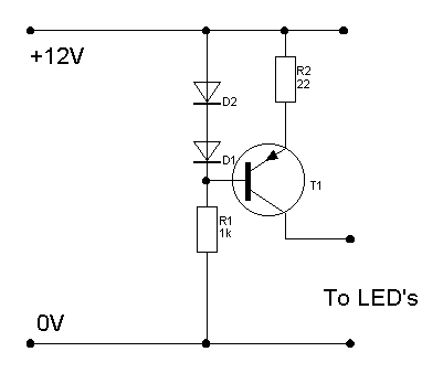

Something like this!.

Thanks a lot Goodwin for the scematics. I am not good in analog electronics, so if someone could tell me what kind of diodes to use i would be glad. As for the transistor, will it work with a BC547?
If someone feel for it, please give me a short description of how a circuit like this works.
It's a PNP transistor, a BC557 should be OK, any silicon diodes will do, IN4148 are a standard small signal silicon diode which I often use, they would be fine.
If you wanted to use a BC547 you could invert the entire circuit, and have the transistor in the negative leg of the LED's.
It's very simple, the two silicon diodes drop around 1.4V across them, and this will be fairly constant. So this fixes the base voltage at 1.4V less than the positive rail. The transistor drops 0.7V between base and emitter, so the emitter is 0.7V less than the positive rail - again this voltage will be fairly constant.
This means the emitter resistor (which is a constant value) has a constant voltage across it, which means (by simple ohms law) it MUST have a constant current through it. Because of the way a transistor works, most of this current will be provided from the collector current of the transistor (with a very small amount from the base current), so the current through the collector will be constant as well.
As the only place the collector can provide this current from is through the load, the load current will remain constant as well.
It's not a 'great' circuit, but it's simple and cheap - and will work a LOT better than a resistor.
To alter the current simply change the value of the emitter resistor, lower is more current, higher is less current.

This circuit works fine, though I don't really understand the thing about R1 at 1K. What task does that resistor have in this circuit?
It provides the required current through the two diodes, and also provides the base current for the transistor - without it there it wouldn't work at all.
I could use this for a same kind of "led series", but with a forward voltage of 8.8 V, right?
Yes, the circuit will keep the current 'constant' for one LED or above - until you run out of voltage!, probably at around 10V-11V of LED's.

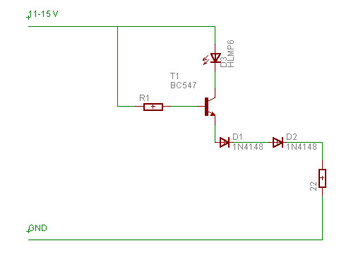

I have tried to make a circuit with a BC547. But I suppose something is missing here, or maybe everything is wrong. Please help me to finnsih the scematic to get the same function as in the scematic above with a PNP transistor.
It's wired totally different to the previous circuit I posted!.
The 22 ohm should go from the emitter to 0V, and the two diodes from base to 0V - just a mirrored image of the previous version.

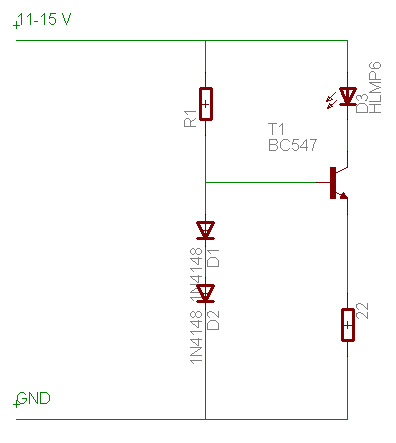

Ah, now I get it, it's that simple. Thanks for explaining for me!
