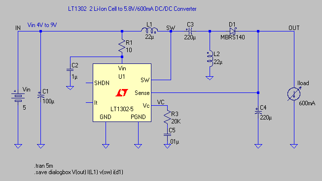

I need a part, or a circuit idea, to use for a 5V switching supply. The Vin range will be 8 volts max down to perhaps as low as 1 or 2 volts. Output must be 5V tol 5% for a powered USB system. I've found several small switcher chips but none that fit my needs :( Thanks for any help.

Have a look at the Linear Technology range LT3489, LT3477 HF Boost Regs.
I wonder if it's possible to bootstrap a SEPIC converter IC?
I wonder if you could increas R1 to something like 100:eek:hm: then stick a diode from the output to the power supply of the IC?
This will work if the IC will start working at 1V and step up the voltage sligtly above 1.6V which will cause a run away effect until the IC is being powered from 5V.
Note that I haven't looked at the datasheet, this is just a random idea.

Ended up going with the Linear LTC3780 until they can get me samples of LTC3785. That'll get me down to 2.5V in IIRC, which after talking with the project coordinator another round or two should be OK.
That's fine for stepping 1.5V up to 5V but it won't step 8V down to 5V.
The probelm with the SEPIC converter is the IC won't work when the input voltage is too low but it's possible to power it from a blocking oscillator type boost converter that will work down to under 1V and give 3V on the output. I'll post a schematic if you're interested.
