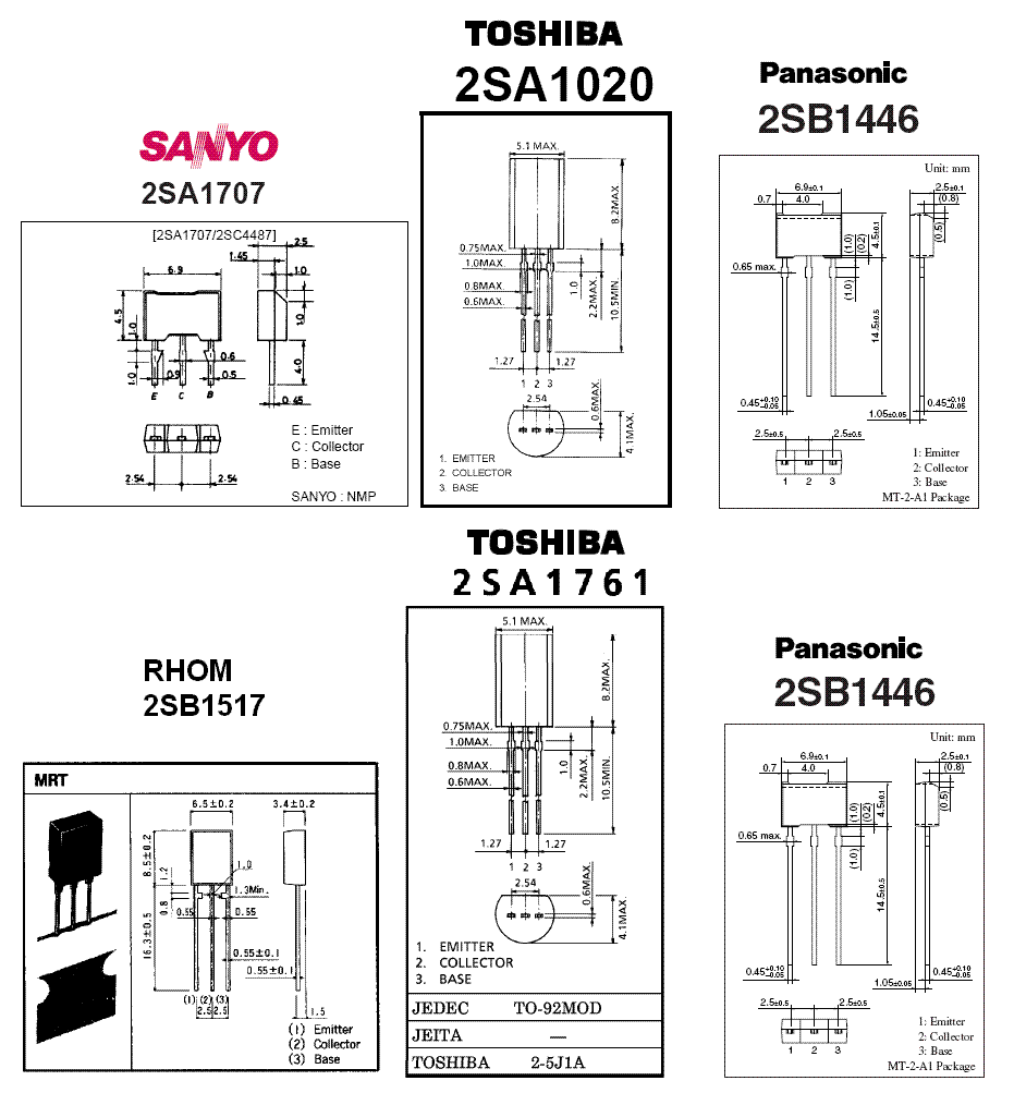

2sbxxxx means it is a low frequency PNP transistor.
2SB1497
Substitutes
2SA1020
2SA1066
2SA1707
2SA1761
2SB1446
2SB1517

thanks a lot hotwaterwizard. hava a nice christmas to you and to all electro-tech-oline members.
