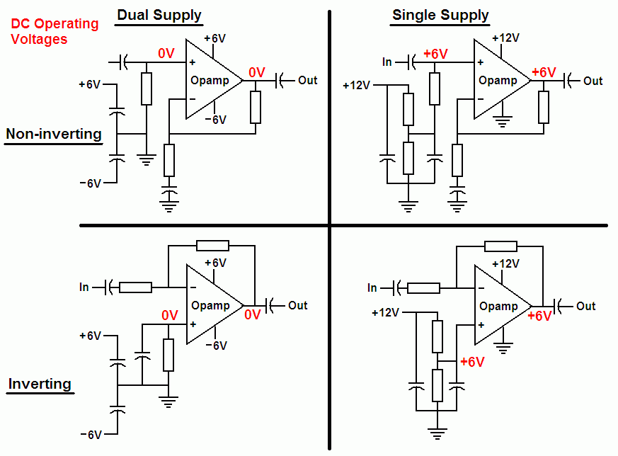

Just use a single supply and make your own ground:
Your non inverting single supply has 3 resistors and one capacitor connected to the + input. This could be done with only 2 resistors.
