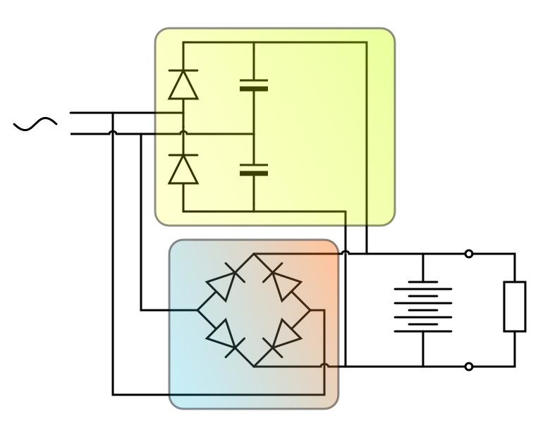

Hi. Is this something stationary, or is it mounted on a bicycle or something?
Reason why I ask is that If it's stationary, you could always use a 12V battery* and a regular (or multi phase) diode rectifier between your printer motor and the battery to maintain the batteries charge.
Also you can add a two-diode rectifier, combined with a cap to get twice as much output voltage, so that the battery will charge at lower speed too.
* Like the battery in cars, but suitable to other purposes than deliver power to start a fuel engine - don't know the english term of such batteries, but sure you know what i'm talking about.

Drawing attached

Maybe something like this would work for you.
