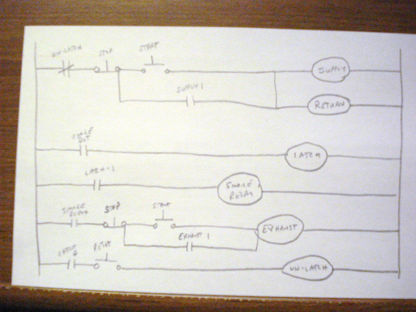

Here's the summary:
- A push button is used to start a supply fan (controller 1).
- A return fan (controller 2) is interlocked to start automatically with the supply fan.
- In the event of a smoke condition the fans shutdown automatically.
- The supply and return fans cannot be restarted until the smoke detector system is reset (a latching relay is going to be used).
- In the case of excessive smoke, an exhaust fan (controller 3) can be started but only if the smoke detector system has not been reset.
A need to create a ladder and wire diagram.
I'm having problems from the third step down.
This is what I have so far:
I'm having problems setting up the latching relay and the exhaust fan in the diagram.
I tried to post a diagram of what I had so far but it didn't go through.
I'm having problems setting up the latching relay and the exhaust fan.
You mention that you have to create a ladder and wire diagram.
Are you going to use a PLC programmed in ladder logic or are you going to do the assignment with relays, hence the need for wire diagram?
If using a PLC, surely there should be some SR (Set/Reset) flip flop software elements in the application? If using relays, latching relays are available (relays with a Set coil and a Reset coil)
