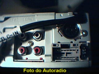

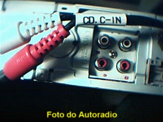

hello eletronic experts!!
First of all i´m sorry for my english but i´m from portugal... I´m realy desperate because i have got a panasonic autoradio cq-rdp383n, and i´ve recently bought a dvd player for my car... but i can´t put the sound of my dvd player getting out on the car speakers...i´ve already bought a p2 (jack) to rca male male but that doesn´t work because the auxiliar option on my auto radio is only activated when connected to a cd box ... is there any way to resolve this??

I did a search afetr I posted the first message and I too could find nothing. It looks like the connector on your pictures is round. Are there 13 holes? Mine is 3 rows of 4 pins and a single one at the bottom in the middle. I also learned that some panasonic receivers used a square plug of some sort.
I'll continue looking around.

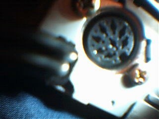

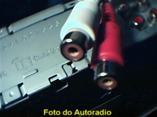

I´ve taken some photos to help out... oh!! thanks for the help MrMikey83 ...i´m realy becaming desperate on this one...
I think that have 8 holls on it..

Might not be much help?, but that looks like an 8 pin DIN plug - so at least the connector should be freely available!.
thanks..
At least now i know the name.. i´m going to continue to make some researches how this kind o connector works...if anyone could help... I realy need it!!
thanks
The problem is that every manufacturer uses a completely different system! - but you can buy adaptors to connect different makes of CD players and car radios.
However, they are expensive! - it's not usually just a simple lead, it contains electronics (almost certainly a micro-controller!) that converts the system communication from one system to the other.
Incidently, I've got access to Panasonic UK service - BUT, they don't list car audio at all, so it's probably done by a completely different company?.

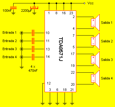

So people i´ve got a second way to do it.... what about i make an amplifier? i´ve a got a very but very simple project of an amplifier but just like i said i would be needing some help to build it...i´m a litle shamed :oops: by asking you this because i know this is a very simple project... So my doubts are...
1º- Can you help me mto make a partlist and what kind of plug does the circuit takes in the entries and in the exits?
2º- can anyone tell me where will i connect the amplifier in my radio?
3º- what kind of alimentation does it takes? 12v?
4º- the project says that we shoul use an equalizer? can i built one? is it realy necessary?
5º where do i connect the 12/3/6/18 and 21 pin of the ci?
6º- how and where will i connect the 1/8/16 and 23 pin othe ci and the 100nf and 2200uf is it all together?
Please be pation....NEWBIe in the place... :oops:
About the way ear is the explanation of the circuit...
"Este circuito entrega a cuatro parlantes el total de 40w sobre 4ohms y alimentado por 12v. Es por ende ideal para ser utilizado en el coche. La distorsión harmónica total es algo elevada, cerca del 10% a máxima potencia. Pero a media exigencia (20w) no llega al 2%. De todas formas no se pretende tener un sistema de alto desempeño en el coche.
Armado en torno a un integrado ideado para audio en automóviles, este circuito permite ampliar el sonido del auto radio o conectar un reproductor portátil de MP3 en el mismo. Internamente el chip dispone de ocho amplificadores operacionales que son dispuestos en puente, permitiendo así que cada terminal del parlante sea energizada. No hay que conectar el terminal de parlante negativo a masa, porque se estaría produciendo un corto circuito en la salida.
Como siempre en esta clase de desarrollos, la disipación térmica es un factor decisivo ya que una correcta refrigeración garantiza un funcionamiento estable, pero una ventilación deficiente puede dañar el circuito. Pese a tener protección térmica interna un calentamiento excesivo es letal para el integrado.
Si desea emplearlo en casa (no lo recomendamos) deberá usar una fuente de 12v capaz de drenar hasta 250w sobre 12v. Recuerde que el filtrado de la fuente es la clave del éxito en cualquier montaje de audio. Utilice condensadores electrolíticos grandes para eliminar el rizado y, a su vez, condensadores cerámicos para eliminar RF.
Para las entradas utilice cable apantallado y clavijas RCA hembra. Para conectarlo a un radio de coche es recomendable colocar entre éste y el amplificador un ecualizador pasivo que, además de controlar el tono del sonido, disminuye la potencia de la señal.
En el coche tenga mucho cuidado de donde obtiene la alimentación pues este sistema demanda gran cantidad de corriente. Si lo coloca en las vías de los faroles es posible que el sistema eléctrico del vehículo se dañe o, en su defecto, puede fundir el fusible. Una buena alternativa es colocarlo directamente de la batería del carro y conmutar la alimentación por medio de un relevo de faros halógenos con la bobina conectada en paralelo a la antena eléctrica o a la salida de control de equipo existente. Si no dispone de salida de control deberá recurrir a su capacidad inventiva para lograr sacar del interior del radio un cable conectado al interruptor del mismo

I´m going to build the mini amplifier... that way i can put the sound getting out on the speakers... If anyone can help....
"So people i´ve got a second way to do it.... what about i make an amplifier? i´ve a got a very but very simple project of an amplifier but just like i said i would be needing some help to build it...i´m a litle shamed by asking you this because i know this is a very simple project... So my doubts are...
Please be pation....NEWBIe in the place... "
