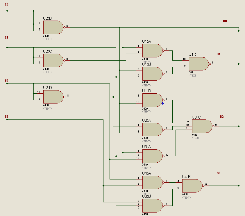

I have to realize convertor xs3 into bcd, for numbers 0 to 9, using only basic logic circuits and T flip flops. I need tables, Karanugh maps. Please help me, it's urgent!!!

here you go ..
just check it out as last time I did this was 15+ years ago .. so make the truth table and check it over the circuit (if you have ISIS I can also upload you the design file)
