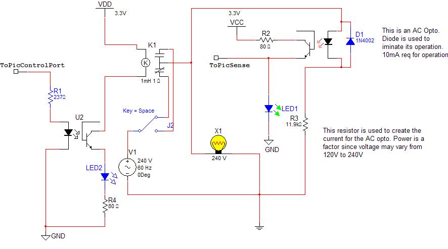

Hello,
I havethe circuit diagram below. I did it with multisim. But before I go on ordering parts I will like ideas/comments/suggestions about it. If there is anything I should change or should have done differently. I want this circuit to be safe and of a commercial grade, even dough I'm only going to use it in a few rooms. The concern I have is with the power consumption of the resistor to drive the ac optocoupler. at 120V power is low at about 1.2W, but if I was to use 240V then it goes up to 4.8W. I was thinking of using resistors in parallel to account for this, but if anyone has a better idea, let me know.
Circuit is simple. A three way switch to control the light independent of the Pic. and a relay which is controlled by the PIC. The AC opto is used to tell the Pic if the light is on/off

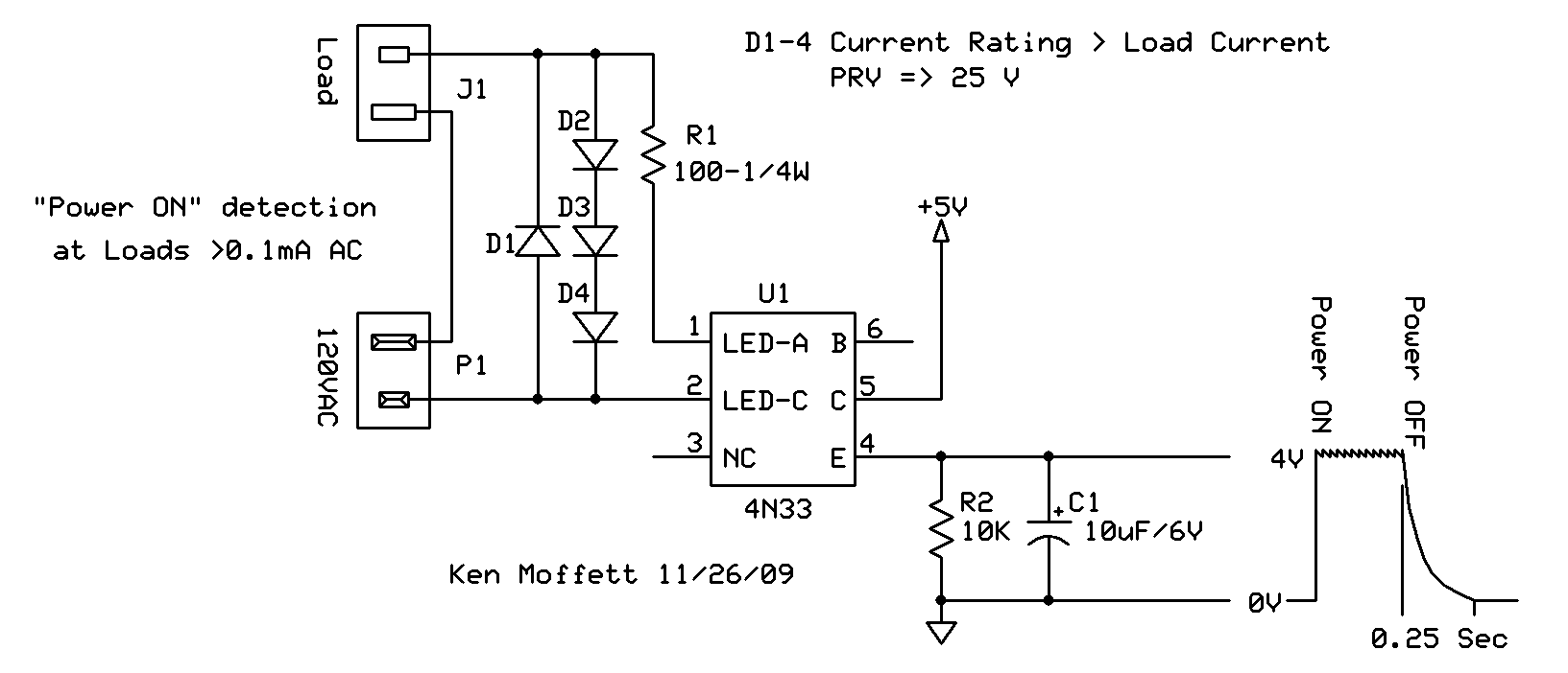

Any chance that you can put this in series with the lamp instead of parallel to it? No big dropping resistor, and it will work with any AC voltage above ~3VAC. It also indicates if the lamp is burned out. PIC tries both switch options, and if no output, the lamp is open. C1 isn't needed if the PIC just needs to see the 50/60 HZ pulsing DC.
Ken
So, what you are really doing is just using the diodes to dissipate power instead of resistors. The opto you are using is not for AC, not a big deal, but I'll rather have a logic out.
Yes, sort of. D1 acts as a -0.6v shunt regulator and dissipates 0.6v x load current for one half cycle. D2/D3/D4 act as a +1.8V shunt regulator and dissipates 1.8V x load current for the other half cycle. Total dissipation is ((0.6xI)+1.8xI)/2). Your resistor's dissipation is proportional to line voltage. My diodes' dissipation is proportional to load current. The higher the load current, the less advantage mine has. ;)
What optocoupler are you using that has an AC input and a logic output?

The 10 MA If for the LED is what is needed to drive a Ic of 50mA. Since the your output, LED/resistor, only draw 20mA, you might be able to get by with a lot less current on the PS2605's LED. I would try it on a bench supply just to see.
With the resistor, LED, Relay, and transistor in series, you will never get the relay to turn switch. In fact using a 5V relay on a 3.3V supply would be marginal at best. Also the arrangement of R2 and LED1 will not give you logic level signals into your PIC.
What diodes should those be? I can build both circuits and see what happens.
The diodes can be any silicon power diode with a voltage rating >25VDC and a current rating greater than the current required by the lamp. What's the wattage of the lamps you will be switching?
With that circuit you posted, aren't you putting in > 1A to that opto? Looks like it will blow up, or I might not be understanding something. Explain please.
No. As I said the diodes act as shunt regulators. The resistor and LED are across 3 diodes in series on the positive half of the power line cycle. Each diode drops 0.6v, so three diodes drop 1.8v. That's the peak voltage applied to the 100Ω resistor and LED. 1.8v-1.6v(Vf of the LED) divided by 100Ω equals 2mA. On the negative half cycle they are across one forward biased diode, so see a reverse voltage of -0.6V.

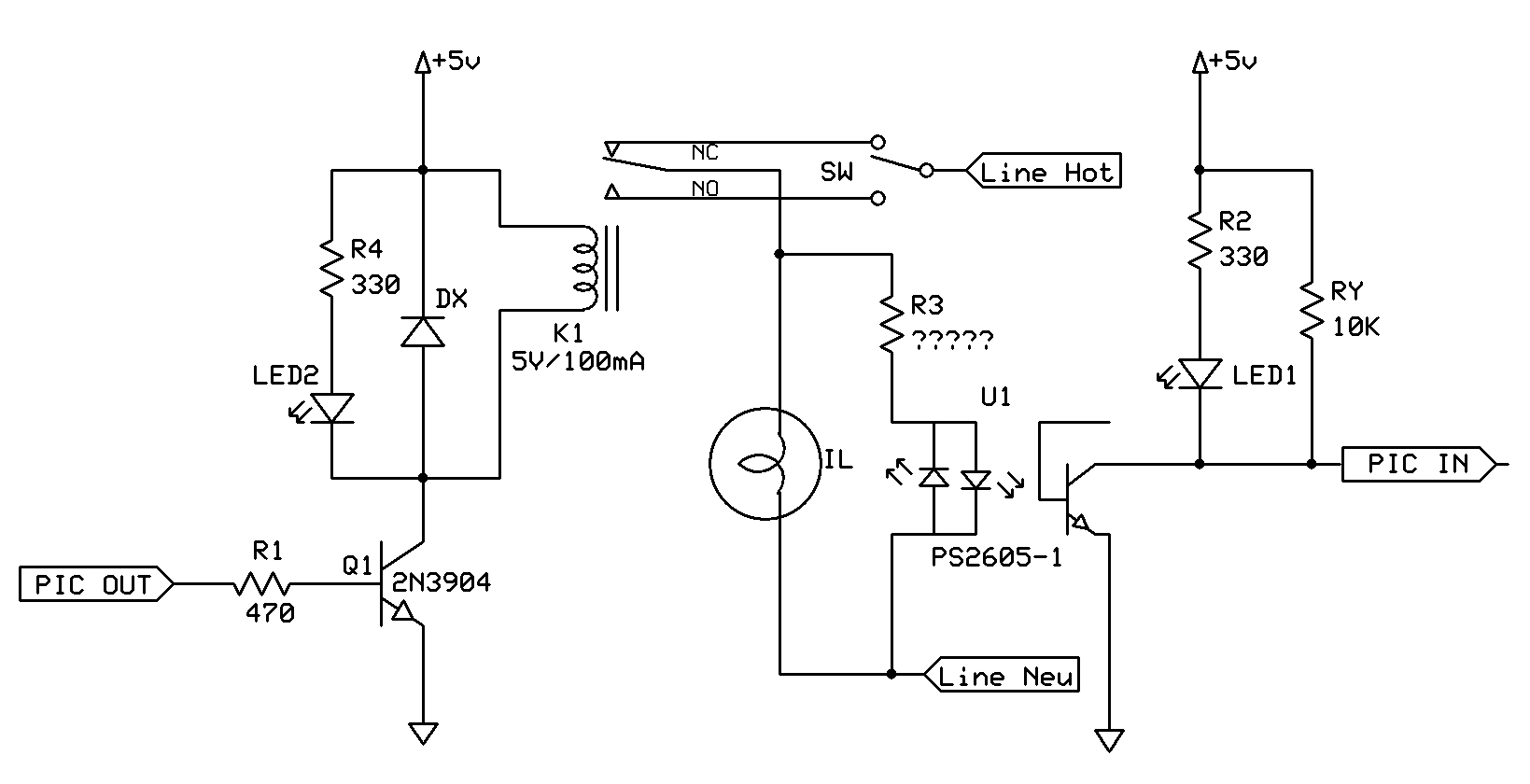

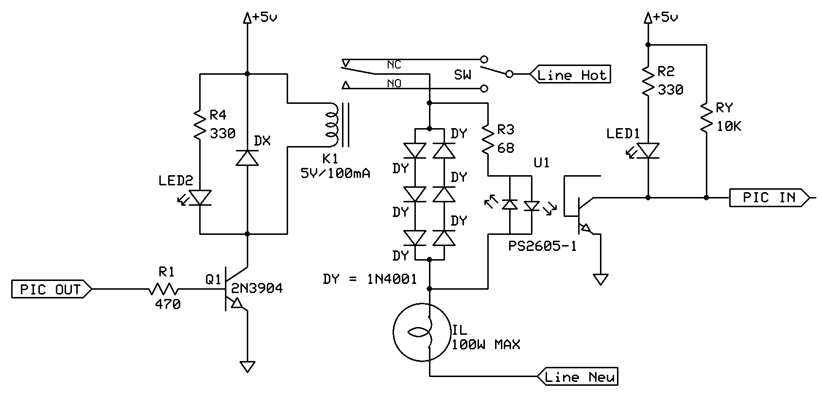

I attached two schematics that might work.
DX is an anti-flyback diode to protect the transistor from the relay's reverse voltage spike when it de-energizes. Best practice is to include it.
In the both schematics the PIC output opto-coupler is replaced by a transistor. Ry is added as a pull-up on the PIC's input. It may not be necessary.
In the first schematic R3's value is still unknown, based on the PS2501's gain. And, by moving the LED to the collector you take full advantage of the coupler's transfer current gain.
The second schematic uses my diode configuration. Again, the diodes's current ratings depend on the IL wattage. It looks the 1N4001s will work.

Mars? I don't I'm going there yet, maybe my next life...:)
Yes, the Q1 was going to be my next question and you have answered that.
From both circuit I think the second one will be a better choise for me.
I have not been playing with electronics for a while so I need to look more at the circuit with the diodes (DY) and R3 so that I can understand it a little better.
For you to end up with the 27Ohm you are accounting for the resistance that exists on K1 contacts and whatever the lamp resistance is right? How exactly is this value being calculated?
I have ordered the parts already and will be bulding the circuit once I get them in and make a project thread here with pictures/videos.
The voltage drop across the three diodes in series is ~1.8v. (OPPS!...Just checked the Datasheet...I had used 1.6V for the LED's Vf) The drop across the couplers LED is ~1.17V. For a 10mA current through the LED the resistor has to drop 0.63V: (1.8V-1.17V)/0.01A=63Ω. So, change that to 68Ω on the schematic. I've used 100Ω resistors on this circuit before.

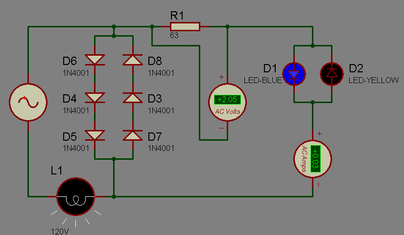

I did the circuit in Proteus to simulate. the LED current shows to be 30mA.
Vr1 = 2.05 which comes from .69*3? so the Vf of LED is not taken into account?
I set the LEDs Vf to 1.17 like on data sheet.
Maybe is just because it's simulation.

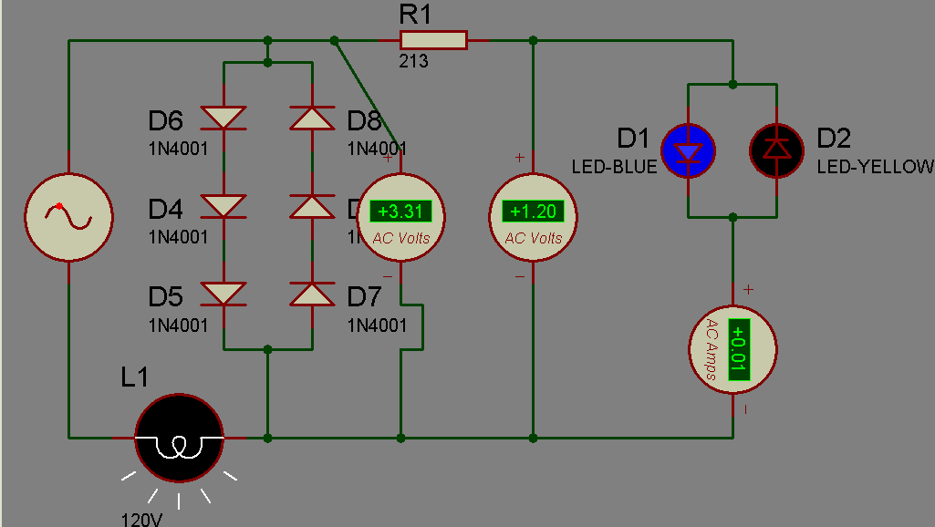

I did another one.
According to the simulation the voltage across the diodes is 3.31. So ((3.31-1.17)/(0.01)) =213Ohm.
This gave out the correct current delivered to the LEDs.
Does Proteus have an oscilloscope function? What's the peak voltage across the diode string? There a lot of variables in components. That's why I like to "bench test" circuits.
oh, another question. Why .6 and not .7 for the diode Vf?
Vf on 1n400x diodes can vary from 0.6v to 1v depending on If. I just use 0.6v as a standard.
