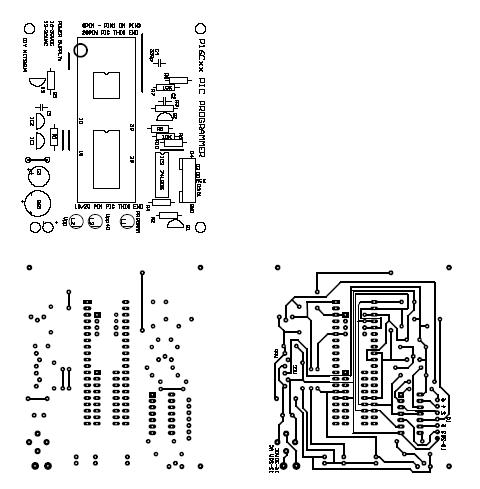

hello guys i need the PCB layout for the P16PRO programmer. can anyone share its layout?
another question.since this is the 1st time i build my own programmer and 1st time i interface to pc,i need some helps. from the diagram of P16PRO, the pins 2-6,10 and 18-25 is connected. then wat about pins 1,7-9, 11-17? do i need to connect or leave it unconnected?
i got the P16PRO schematic diagram from https://www.electro-tech-online.com/custompdfs/2003/12/p16pro40.pdf
but at the bottom of the siagram,it is written "P16PRO programmer for PIC16Cxx microcontrollers by Bojan Dobaj".since i want to use the programmer for PIC16F84A and PIC16F877 but not PIC16Cxx, is it compatible with those chips?
i also downloaded the PCB layout from https://www.picallw.com, which is shown below:
and decide to build it.is this PCB layout certified working?because next week is my exam and i dont have time to redo it if i doesnt work.

i programmed 16F84, 16F628, 16F876, 16F877, 12F675, 12C508 with P16Pro40 upto now.
Many other chips will be programmed with p16pro40 as well, Its the software u use to upload that's more inportant
I use WinpicProg and IC-Prog
Winpicprog is faster and better for the above chips, but the 16F876A, 16F877A are giving me troubles with Winpicprog, so i use IC-Prog for them

i built the hardware and installed the software.but the programmer seems not working.the green led keeps glowing and nothing happen.... :cry:
If you are using WinPicProg you can manually toggle the output lines from the Hardware screen - in this way you can check and confirm that everything is connected and working correctly - just use a voltmeter on the pins of the PIC socket and make sure they change when the correct buttons are toggled, and make sure they change the correct way!. The other two LED's should light when you turn on Vpp and Vpp40.
