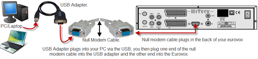

You gotta use a usb to serial adaptor and a DB9 cable for programming. But I'm a bit sceptic about the convertor. Might need the full swing of the real RS232 goodness.
look at this picture there are two cable that is used for serial communication from laptop to db9 connector
So I need two cable or only one usb to rs232 db9 serial cable
USB to RS-232 cable should have a male connector
dev board should have a male connector
USB to male connector + db9 female connector -----------------------db9 female connector + db9 male connector from development board
