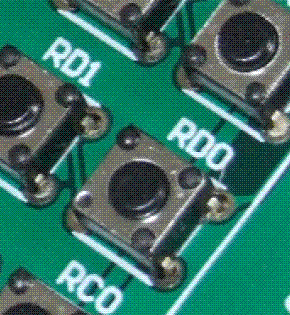

Help me plz,
i am new to eagle.
i found about one hour but it did not find me. i am making schematic with eagle first time. Where will be this button???i mean which library or model number?

When you are picking parts at the bottom is a seach box. Did you type *button* in there and look at all the buttons? Make sure you put the to "*".
Ayne said:
What is the exact name of those button(in picture)???
It is a momentary push switch. Bill from blueroomelectronics.com I think uses something like that on his boards. You can look over there for the name. Also Eagle has a download site for parts not in the default library.
