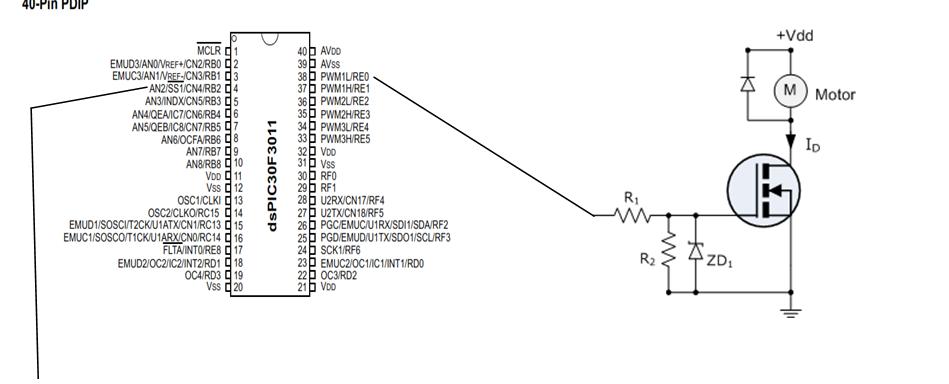

I need some help figuring out resitor values in this circuit.
darkknightgaury
Please review the attached image for reference.
Hello, I am currently an entry level engineer at Boeing. I am doing a simple demo on brushless DC motor speed control using PWM and a MOSFET.
My question is, should R1 and R2 equal to 10kohm if so why...
What issues might my circuit have... and what are the topics I should be reading to learn more about Motor Control. Any favorite books or sites?
