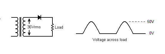

I have a half wave power supply that 120v, 60hz transformer with a 36v sencondary winding. i also have a silicon diode that transform the secondary ac into pulsating dc. what would be the peak voltage of the dc pulses across the load:?: thkx[/b]
it really depends on the load ..
if the load is purely resistive ,and is a high resistance , then the Vpeak will be around 36V..
If your transformer is 36V RMS, then the peak voltage will be 36* Sqrt(2) = 36*1.414 = 51V
This will be with no load. As you increase the load then the voltage will drop.
If your transformer is 36V RMS when fully loaded, its voltage will rise with no load maybe to 39V. Therefore the peak is root 2, times 39V = 55.1V minus about 0.7V for the diode. Maybe in down under, transformer output voltages don't increase when not fully loaded. :lol:
I stand corrected, the 36V will be when loaded. I blame it on this cold winter weather were getting down here making my brain work slower. It's midnight here and the outside temperature has plummeted to 14C :shock:
SO the load across R(load) will be 51v what about the hafl wave, does it play a part in the load?
Re: ????
The peak voltage across R(load) will be 51.
I don't understand your question.
