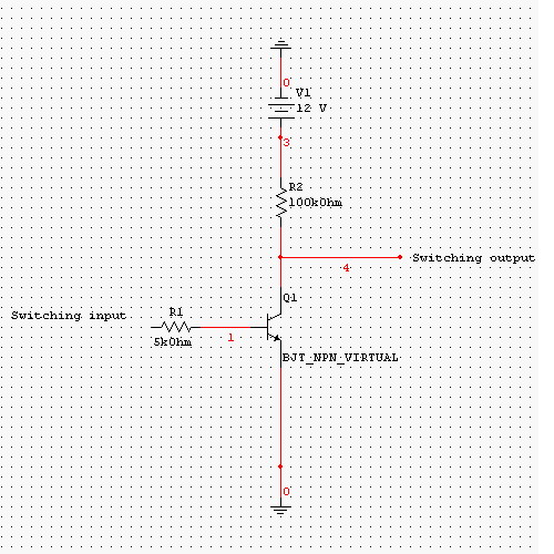

Heres a simple NPN transistor switching sample.
When the 5kohm resistor will get a 5V input it will output 12v.

Why does the resistors have to be such a high resistance? to protect the transitor?
no, the resistors have such a high resistance so as to keep it deep into saturation. no matter what the input voltage the circuit will act as a switch. but this is not the kind of switch u need. this is a digital switch. u need an analogue switch. a solid state relay or an SCR should be your choice. what are your current requirements. and when u say simple 12VDC what do u mean. is that the voltage that is going to trigger the switch or is it the voltage that is going to be triggered.
