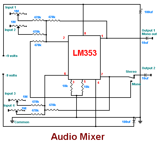

I want a mixer that connects to an amplifier to give the final output. The mixer should be stereo and having about 6 to 8 channels. The mixer will have connected to them mice to aux (CD players, ecc.) connected to them using preferable an xlr. If some one has a good schematic and maybe tell me how could increase the number of channels.

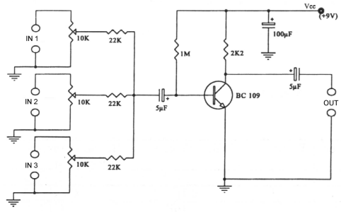

I have found this schematics but they didn’t convinced me since one I saw it to be complicated and the other looks that it is a mono mixer below are the two I just mentioned.
Schem is the mono the other is the complicated one

I suggest you just buy a mixer, it's easy enough to build a simple mixer with a single opamp, a few resistors, and a number of potentiometers - doubling it for stereo - but you can buy great quality mixers for very little money (check out Behringer ones), just the pots and knobs for your own would probably cost more. The bought mixer would provide a great many more facilites than a simple one you make your self - but if just line level inputs, and no tone controls, are all you require? - then it's not a hard job.
I agree with Nigel, I have built an 8 channel mixer and what you are doing is building 8 mono inputs with amplifiers then mixing them into stereo, the above circuit is a 4 input mono mixer
