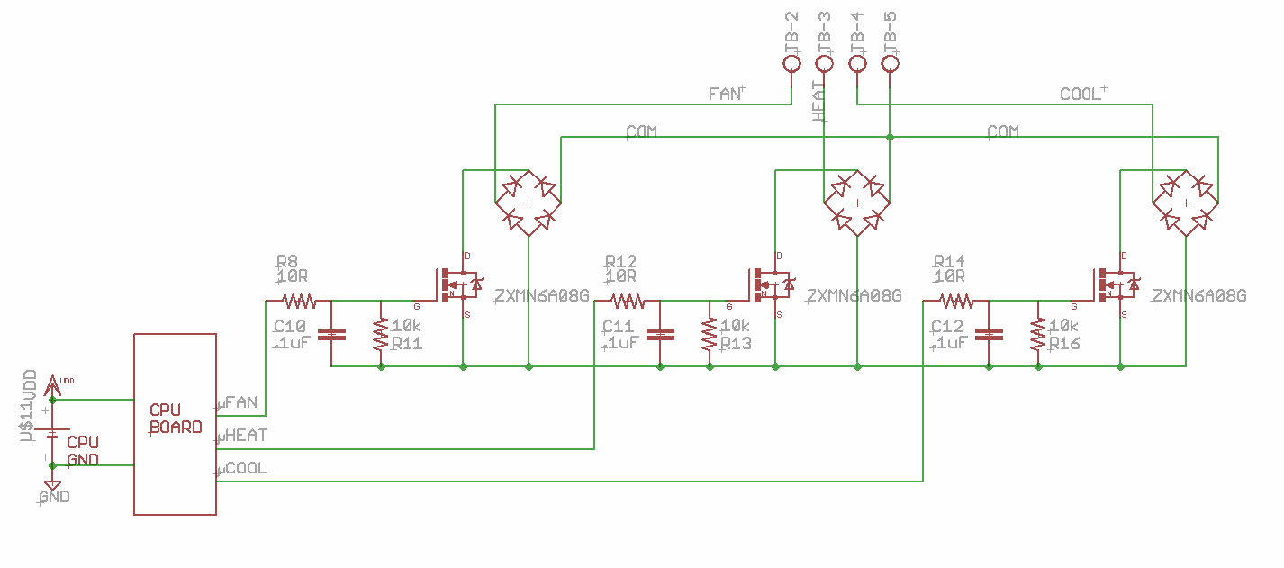

I need to replace relays on a Thermostat with Mosfet
igeorge

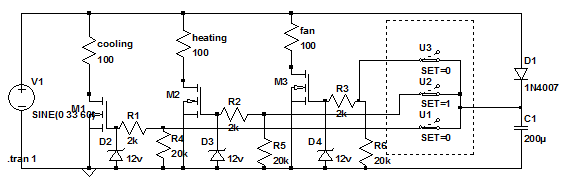

I want to replace the latching relays in a thermostat with mosfet
I found on the web a sugestion, but i am not sure if it is OK
At the furnace it is a 24VAC transformer
One wire come to the thermostat and return by closing the contact in one of the 3 relay
I am not sure if it is correct to connect the CPU ground with the wire coming from the thermostat
Please help

When COM goes negative, you get it in the following order: Negative(COM) - Diode - GND - Mosfet - Diode - Load - Positive
I guess during this phase they want the capacitor to charge.
When COM goes positive, you get it in the following order: Negative - Load - Diode - GND - Mosfet - Diode - Positive (COM)
I guess at this stage they want the capacitor to stay charged and keep driving the mosfet.
If that's how it's designed, you only need to drive mosfet when COM is negative. At which point GND is a diode drop above COM. So, you can use another diode to connect your controller's ground to COM, and VCC to the other AC line. However, this way you only get power when COM is negative, so you probably will need a big capacitor to keep the power on during the half cycle when COM goes positive. Most likely, instead of connecting controller directly to lines, you'll need a voltage regulator for the controller.

I thought that COM in schematics was a 24VAC line to be used as a power supply.
If you want to use an isolated battery power, you could connect two diodes between COM and other AC line in series (looking in opposite directions of course), and reference your ground to the point between diodes.
When COM is negative, your ground will be the same as mosfets.
When COM is positive, mosfet ground will be at your ground when mosfet is off, but it'll go 33V higher if mosfet is on. To prevent the capacitor from discharging through your controller, you may install a diode on each of the mosfet control lines.
It's a very strange design, but it should work. Basically there will be a missing 2.4 V piece of the 24 VAC line centered around the zero crossing.
Note that there is a GND, and a COM. The u in uHEAT means the microprocessor side. I would have labeled GND uGND.
I too, think it's unclear. Somehow, I think that R should be connected to GND and you need to ignore COM.
Adding a fuse, would be a good idea.
In reality, you could breadboard one of the circuits with a small fuse (0.5A). like FAN with a battery pack and go. The furnace should be fused at a little over 40 VA/24 or usually 3A or use an energy limiting transformer. It's not guaranteed though. They usually put the fuse in the R lead before it leaves the furnace. An automotive 3A blade fuse is common.

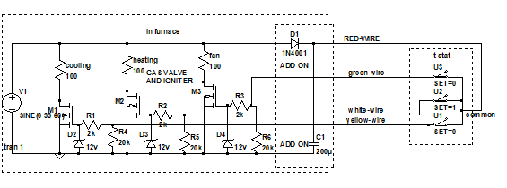

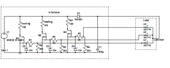

after a few assumptions of the t stat is battery powered and simply a switching mechanism, like mine, and the furnace has a 24vac transformer, like mine, and it has the standard 5 wires to it like mine, here's what i would try..
Because 24vac is 33vp-p and one leg is grounded, you will get a 33vcd on your cap, too much for a fet gate, so I added zeners to hold it down to 12.
Good luck, please let me know how it works out.
PS according to Spice, The zener will dissipate 120mw, the 2k resistor will dissipate 200 mw, and the 20k will dissipate 50 mw

In simulation, put an AC source between COM (What I believe to be R) and your furnace relays. Have those relays return to the other side of the AC source.
Your load could just be a resistor, say 24/0.030 ohms for simulation. So, tie one end of the resistors together and to one side of the 24 VAC simulated source.
Put the other side of the 24 VAC simulated source to COM. Put the other end of the resistor to uFAN, uHEAT and uCool.
This should verify operation. As I said earlier, I think the point labeled COM is actually R on the stat. To make matters wierd, R is a "common" terminal to each of the contacts.
R to G
R to Y
R to W
Any diode and any fet that you have in your library will work, I just grabbed the first ones I found for the simulation, the spst switches just represent what ever your u Processor has for a switch. Some t stats have what's called a heat anticipater which is just a series resistor in line with the t stat switch, but it went away with the mercury bulb t stats. Others use power from the furnace transformer to operate. Mine, and I assume yours, run off batteries and there fore are just switching apparatuses that can be programmed to switch when we want them to. I don't think you need the full wave bridges either, a FET will pass current both ways as long as the gate is biased on and your fets are good for 60 v and 3 amps so you should be good.

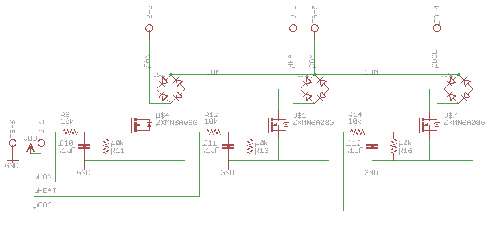

Could you explain your design more? If you put AC on V1, then when voltage becomes negative on the top rail, the mosfets should start conducting (because they act as diodes when subject to reverse voltage). As a result the loads will be subject to half-wave power regardless at what's on mosfet gates. Is that how you want it to be? Or it is not really AC coming from the furnace, but something rectified?
Still thinking about your project, what type of furnace do you have, most fan switched just turn the relay of for the fan which is also turned on by a temperature sensor in the furnace to start the fan after the temp rises from the fire and turned off after the temp drops, if the fan switch is not activated, it is also turned on by the cooling switch and some times, you have one speed for heat and one speed for cooling. Unless you actually use the fan switch, I would just forget about it and leave it on automatic, which is no operation from the t stat

you are right, my mistake, use the bridge

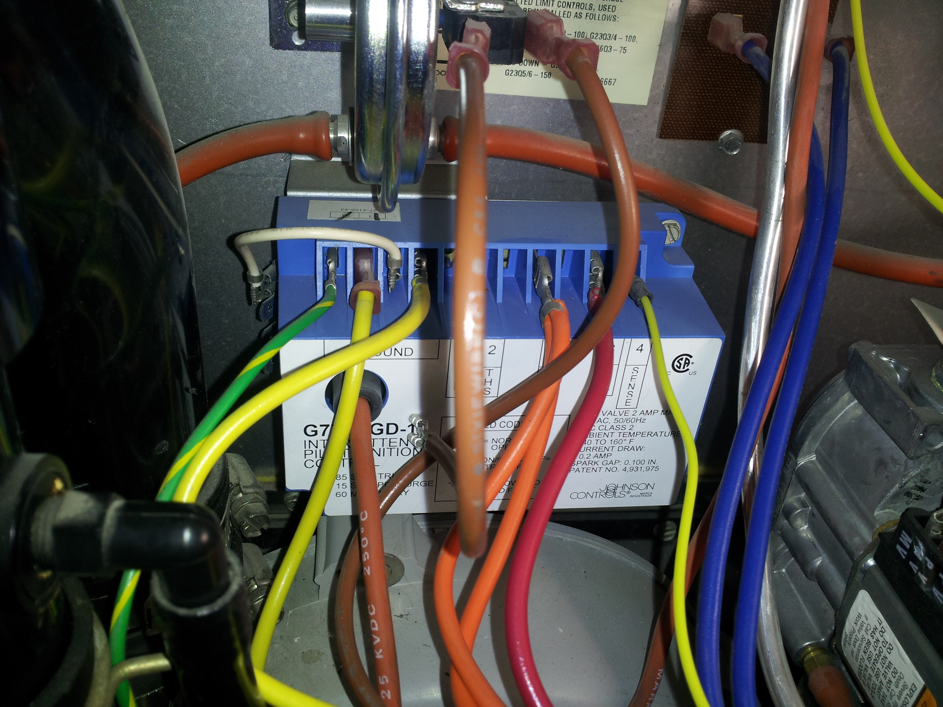

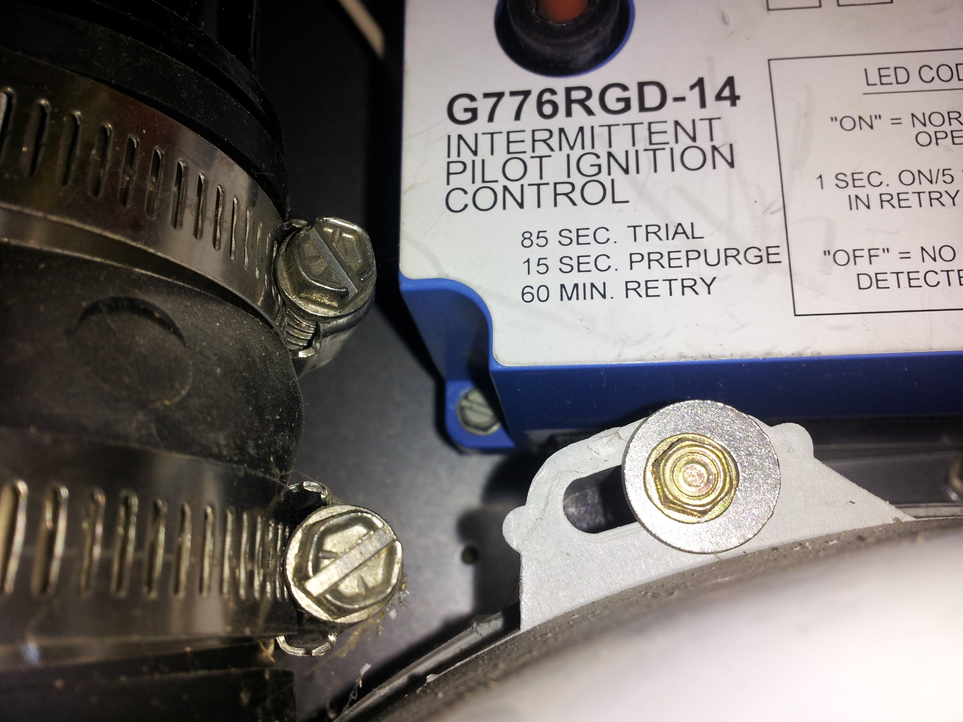

I have a lennox also, here is a photo of my control package on the furnace, is it similar to yours?
