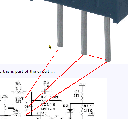

I'm a diploma student and am doin my final project ....
i face a problem with the connection of (trimpot) and i need ur help on it ...
i will post the pic of the circuit diagram and i want from u guys how is the proper connection of this trimpot and how i should connect it with the other components .....
this is the Trimpot
and this is part of the circuit ...
thank u

Trimpot is short for 'trimming potentiometer' usually adjusted using a scewdriver.

Connect this way.

the picture on the side=clue
can't believe that someone looking at the schematic then the diagrahm on the side of the part can't figure out how to wire it up??
