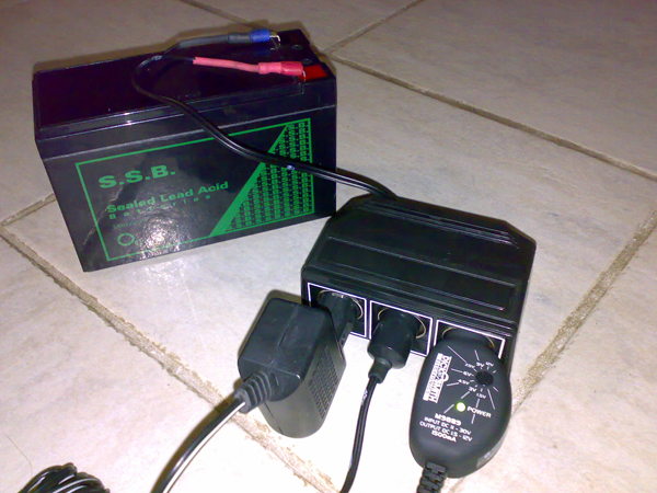

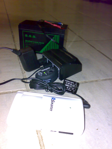

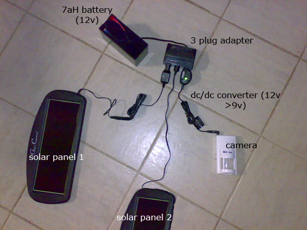

Gday Everyone,
Thanks for your help.
Please take a look at the attached photos of my rig so far. I have the camera powered by a 7aH battery that is charged by 2 x solar panels (100mA each).
I understand that these panels are probably under powered for the drain of the camera, but at this stage i am unable to get my hands on anything bigger before my next visit.
Given that the 7aH battery is at full capacity, and the solar panels are receiving maximum sunlight each day, how long could i expect this camera to still function before draining the battery dead? I need it to go for at least 2 weeks!!! (am i wasting my time?)
There is no regulator to prevent over charging/discharging apart from the built in diode in the solar panels.
Have i wired this up correctly? if not could someone give me the right way of setting this up..
Cheers,
Ashton

Keyword: MAXIMUM. Solar panel ratings (and as many other things) are overrated, literally. Thats if it is perfect temperature, no clouds, in the sahara desert. You won't be able to get 100ma. You may be able to put some juice into the battery though, but not enough to charge it.
Car battery? Besides those rednecks can see shiny stuff, and shiny to them means money? You could hide the car battery in a hole. Camo the camera too :)
Thanks for your help. I was under the impression that if i used a car battery i wouldnt get enough charge time from it? When I go to upgrade the panels. Is it just a matter of plugging it into the power socket in my rig, or should i really have it wired differently?
Would you suggest a minimum panel of 5w?
Yes I would get as large as a solar panel as you can get, in voltage and amperage.
How long will the current above set up take to drain the 7aH battery? Should the camera still work for a 2 week period given that the battery is fully charged?
