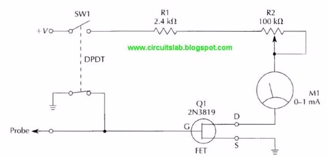

I have few FET but It will work of not I don't know. I have BS170 FET. I found another FET "596s" inside of electret mic. Other FET can't find. Will these two FET able to detect Static cherge like shown in schematic (FET version)?

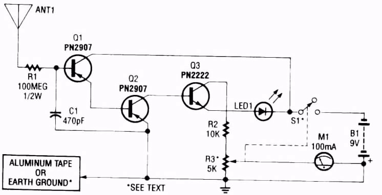

Another is Transistor verson Detector. Is it sensitive? I want to use 557 as a PNP and another general purposes as a NPN (like 547), is it valid?
Do you have any other simpler ans sensitive?
I hope detector will detect charge without touching its probe (Ant), almost far from few cm.

I think I'd go with the JFET 2N3819. High input impedance (which increases with rising input voltage) is a plus.
Downside is a tendency to be very sensitive to built-up static charges.
Probably a JFET front end device feeding a transistor amp section might be best for an antenna type electroscope (don't know how a "probe" type would be a good idea at all...).

The Jfet circuit will detect static very well and the Jfet will survive being ZAPPED if you add a protection circuit (a resistor plus a couple of diodes).
You should look for circuits designed by engineers, not designed by little kids.

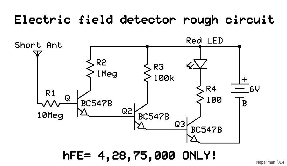

However simplicity of such (attached) basic component based circuit made me attracted me again. What about the circuit? (original circuit had no R1 series input resistor, I added it. But I know it is doing almost nothing.) Will it also can be destroyed? I am little confuse how to make protection circuit using a resistor and diodes as audioguru said before. And is it 'Tarlington'? :)

Hi Willen,
Static electricity builds up on insulators only when the air is also a good insulator. In Canada in winter, sometimes the temperature outside is low then the humidity in a heated home is also low so static electricity builds up when two insulators are rubbed together. When the outside temperature was -15 degrees C, but was 22 degrees C inside then the humidity inside my home was only 22% and static electricity was everywhere! I do not think the outside temperature is -15 degrees C with very low humidity in Nepal unless you are in a heated cabin very high on Mount Everest.
I think most static electricity is negative because electrons are collected on things. But the items that have their electrons taken away become positive.
Take a rubber or plastic balloon and rub it on some wool or fur. If it sticks to a wall then the balloon is negative because the wool or fur had its electrons removed by the balloon.
Your NPN transistors only turn on when they detect something that is positive.
Then I am thinking to use circuit to detect 50Hz hum of mains. I hope I can use it to find broken wire in mains like this way, can't I?
I made simulation of previous 3 transistor tarlington circuit :) . I set 1000Meg series resistance at signal source to give 5V but too much low current at the base of Q1. Now can I say directly- The circuit has 1000Mega Ohms input impedance for simple? (I just want to know general concept)

The signal source has a resistance of 1000M. The input resistance of the transistors is less than 1000M because if their input resistance is also 1000M then the input signal to the based of Q1 would reach half of 5V but instead it reaches to only about +1.65V and -2.2V. The input positive swing is less than the negative swing because the input resistance changes with the input signal level and polarity.
The peak current in the LED is about 7.3mA for 20% of the time and it blinks on 50 times per second so it appears as dim as an LED lighted with only 1.5mA.
