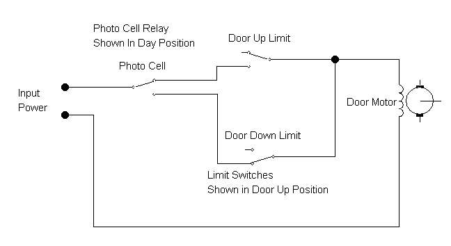

Attached is a schematic for my concept on how to control the door. The photo cell controls a relay that is shown in the up position during the day and the down position during the night. The door (or motor) has two limit switches, one for up and one for down. As can be seen, when the Photo Cell relay changes states, the motor will be energized to move the door until the appropriate limit switch opens and stops the motor.
The motor can be powered by the mains or whatever power source is appropriate. Reasons to use a battery are, if you want it to work if the main power fails, or for safety. If you power from the mains, your must be careful to insulate all connections to the limits switches, etc. so no lethal voltages are exposed.
Also, you would want to have some way to easily open or close the door manually if needed (perhaps a quick release connection for the actuator rod).
The photocell could be the kind they sell in many hardware stores to control outside lights.
For the door actuation you could use a motor with a gearbox reduction which drives a wheel or crank with a diameter equal to the distance you want the door to move and with a connecting rod to the door. Thus the wheel/crank moves 1/2 revolution to open or close the door and always moves in one direction.
The limit switches can microswitches positioned to sense the door or motor crank position.
I don't see any need for a timer. For safety you may want some sort of IR beam sensor which would detect anything in the door opening and stop the motor. Perhaps something similar to the sensors they sell to detect when someone goes through a door at a business.
You probably also should have some method of protecting the motor if the door jams. Perhaps some type of slip clutch or motor overload protector.
So building all this should be a good test for your handiness. Have fun.

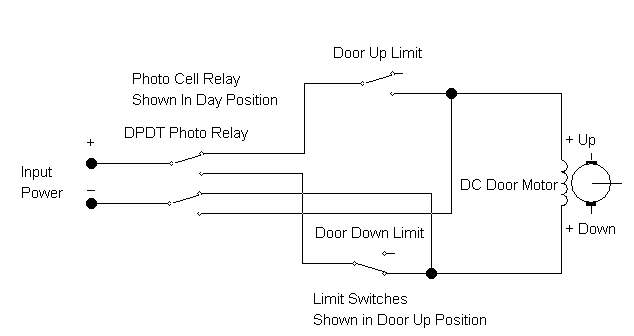

Some thoughts on a low cost motor hatch actuator:
A motor with a gearhead that could be found at an automobile junkyard and has good torque is an automobile windscreen wiper motor. Although they usually only run in one direction, I believe they will reverse if you reverse the input power polarity. They are similar to the one at **broken link removed**
It probably doesn't have enough torque to operate a crank as I previously proposed, but it could operate a small pulley attached to a stranded wire cable. The pulley could wrap up the wire to pull the hatch open. Reversing the motor would unwind the wire, and gravity would close the hatch. Alternately you could run the other end of the cable to the bottom of the hatch with an idler pulley so it would pull the door closed as well as open.
This motor can be run off a 12V battery or 12V power supply. If you use a small 12V rechargeable battery with a trickle charger, the system will continue to operate even with a mains failure (if the photo cell can operate on 12V). You could keep if totally free of the mains if you used a solar cell to charge the battery.
Since the motor needs to be reversed, the connections are slightly different from my previous post. Attached is a schematic. It now requires a DPDT relay for the photo sensor rather than the SPDT previously shown.

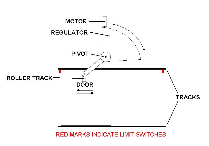

You could use a power window motor. They have plenty of torque and are reversible. not to mention the fact, they tend to be much smaller than wiper motors.Window motors are much easier to wire (2 wire) as opposed to wiper motors which tend to have 4 or more to control various speeds(depending on application)
The RC servo is a good idea but mat be more complex than what Richard is looking to build. Depending on the size and weight of the door though, he may need a high torque servo which wont break the bank, but, can be a little costly($60-$100 US)
Also you may be able to get the window motor with the actuating mechanism that could directly move the hatch.
A definite possibility, as long as space is not an issue. The regulator side of the mechanism tends to be rather large and must be secured in several places unless modified. But, if he has the space, he could set up a really cool system by surface mounting the assembly (slightly modified) on the front of the house and slide the door open and closed rather than swinging it.
