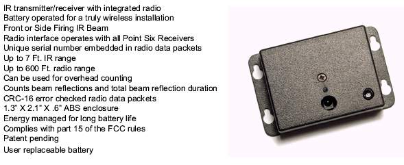

Is there any other means to make a proximity detector with good range and no false detection
