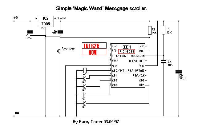

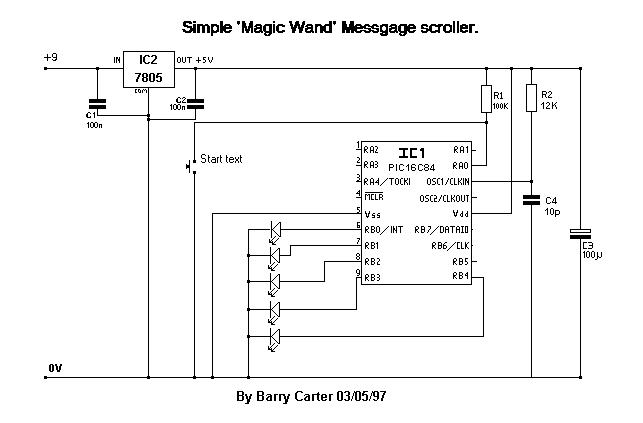

Whats your location.?:)
I have the schematic here. I am in Kansas City, Kansas.
We cannot access the link.:)
Use the 'manage attachments' button lower down the REPLY page.
Follow the instructions to upload the diagram to the thread.
Sorry about that. This should work.
Sorry. Here it is below.

If you modify the code to use the internal oscillator, you don't need the 10pf cap or 12K resistor.
Ok that makes since. So, should i leave open pin 16 and leave open pins 1,2,3,4,11,12,13,15 also?...I heard somewhere that all open pins should be pulled down with a 10k resistor. I do appreciate your help. I posted the chip change above next to the attachment I submitted in another attachment. So, I'm going to update the asm and get back with ya after i check it.
ASM change
OK. I rebuilt the asm and it worked. I left an attachment below with changes in red to turn on internal oscilator. Not sure if I did it right but it went through the Lab ok.
  • msg628aChanges.asm
Good for you. As for floating inputs you can simply set them to outputs and logic low.
So, set all pins to output? Not sure about the logic low.
I guess you mean use 10k resistor to all open pins and pull them to ground?
TRIS = direction (0 for output)
PORT = high or low (0 for low)
Don't connect anything to the unused pins.
