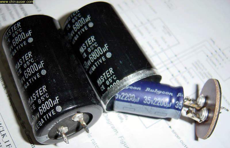

Is this your problem?

Another manufacturer of poor electrolytic capacitors is CapXon they are used in low cost consumer products and are frequently the cause of equipment failure.
