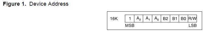

i never seen it but will check it out. I just wrote this and it is untested as i dont own that memory... does Isis have it ?
Here is my untested code made for the "AT24C164" from Atmel.

For the 24C16 I think you need to change it to,

not sure pommie setting it to 0b10100001 changes the address of A0:A2
addr-jpg.26345

i just noticed the zip ill check it now
i will be honest im not sure if those parts in isis follow the same rules as the datasheet for the "AT24C164" But the latest code i posted should work if you remove the ACK commands. I noticed that MCC18 when it Writes it includes that in it,

The addresses are fine now but i get 0xFF as the buffer/PORTD. ANy thoughts?
Please note i turned off SLEW (SLEW_OFF) because the part in ISIS is the 100khz version.
