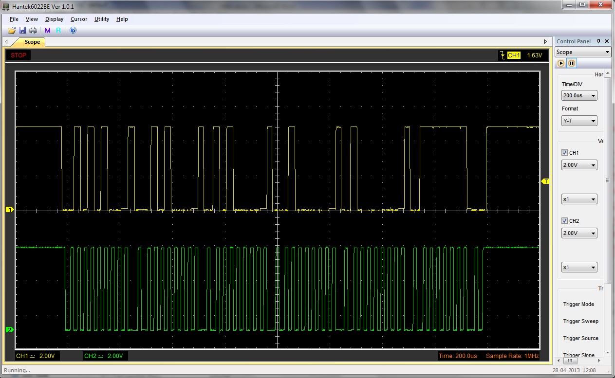

Hello,
I’m having a strange problem concerning the writing of I2C bytes by a PIC18 microcontroller master to a slave. Using the C18 peripherals library ( “i2c.h”, which seems to be the same for either XC8 or C18 compilers) I can write the first byte just fine, from which I think I get an acknowledgement if it is the slave address, but all bytes after that are related to the first written byte. They often appear to be some shifted version of the first byte. If I issue a RestartI2C() command between each byte then the bytes are correct and independent but the slave, understandably, doesn't seem to like this/doesn't respond correctly. The follow code is a stripped down version of what should be the initializing sequence for the device. The image is the subsequent SDA (CH1) and SCK (CH2) signals. As you can see, the first byte seems fine, but the following ones simply are not what I’m trying to write.
I've tried numerous variations of using idle, restart, ack, etc, and nothing seems to work. Any help would be appreciated, I've spent an embarrassing number of hours trying to make this work/searching online for answers.
Hardware/compiler:
Master = PIC18f2525 , Slave = NAU7802 ADC.
I’ve tried both XC8 and C18 compilers (same peripheral library)
Yeah, I wasn't quite sure what you meant, and a quick search didn't illuminate anything. At a quick glance, does anything seem obviously wrong? This half-working (first write byte fine) seems like a strange error.
I just tested your code (sending the first three bytes). At first the data was rubbish - like yours. Then I removed the ACKs - because they are not required when master is sending.
Now the data looks fine on the scope (first three bytes anyway).

Thanks! That worked like a charm, I don't know why I didn't try that. I appreciate you checking that it worked. This should get me on my way to being able to properly communicate with the slave device.
