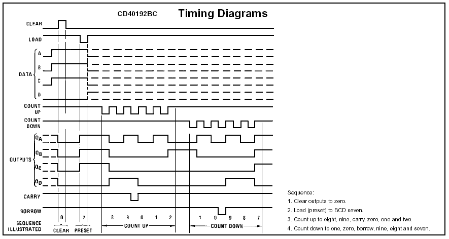

I wonder if it is possible to make a circuit with IC`s (no microcontrollers) that produces a spesified number of pulses? Example - when I push a button, the circuit makes 5 pulses, and then stops. When I push the button again, it makes 5 new pulses. I want to use the output from this circuit into a BCD Decade Counter.
I need to make 4 circuits like this with 4 buttons. I want button 1 to make 1 pulse, button 2 to make 5 pulses, button 3 to make 10 pulses and button 4 to make 20 pulses. All the outputs is going into the same BCD Decade Counter. Does anyone out there know if it is possible to do this without the use of microcontrollers?

design it as a state machine. in my first-year electronics class in college we designed and built a system consisting of a wired transmitter/reciever where the transmitter would send a different number of pulses for each of the buttons on it, and the reciever would simply count the pulses to decode the command, and control some motors as a result.
the whole system was done with sequential logic, and each board had about a dozen IC's on it despite its simple purpose. certainly not minimalistic or elegant, but if you really want to do it truly old-school then that's probably what you're up against. otherwise you can probably cut the number of IC's down a lot by using some special function IC's... some kind of counter chip and a 555 could probably do it without much other logic...

A telephone pulse dialer ic would get you the 1,5 & 10 pulse trains, and with some additional logic probably the 20 pulse train, too. (like pushing 10 twice). They're not too common these days, since most telephone systems use DTMF to dial.
National Semiconductor used to make pulse dialer ic's as part numbers MM53190, MM53143 & MM53144, (all obsolete I believe). Motorola made them as MC14408, MC14409, I think they're obsolete, too. I saw that NTE has part numbers 1691 & 1692, which seem to still be available and not too expensive @ $3-4US . I got all this by Googling "telephone pulse dialer".

See this thread. It does what you want except that it will need expansion to produce 20 pulses.

I mean the programmable down counter wil do the job.

Thank u all for helping. I will try the curcuit in the link from ljcox.
