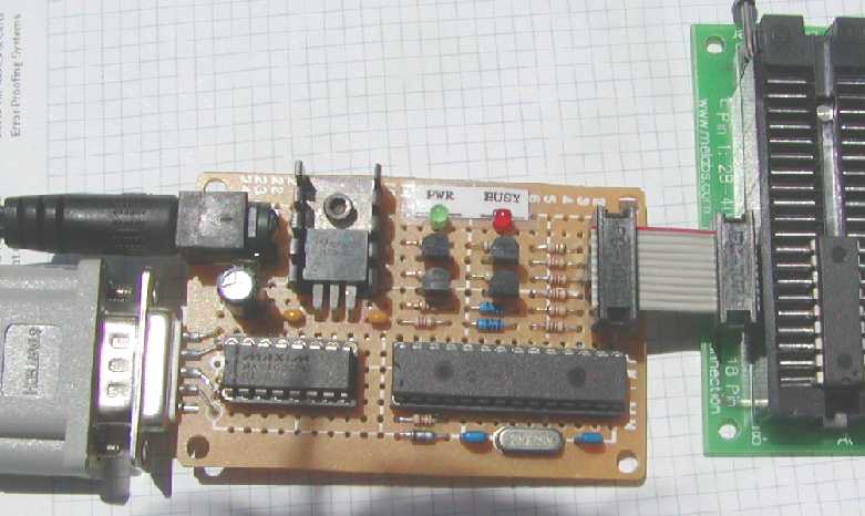

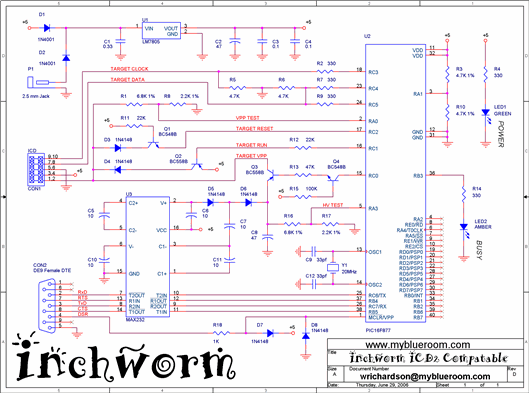

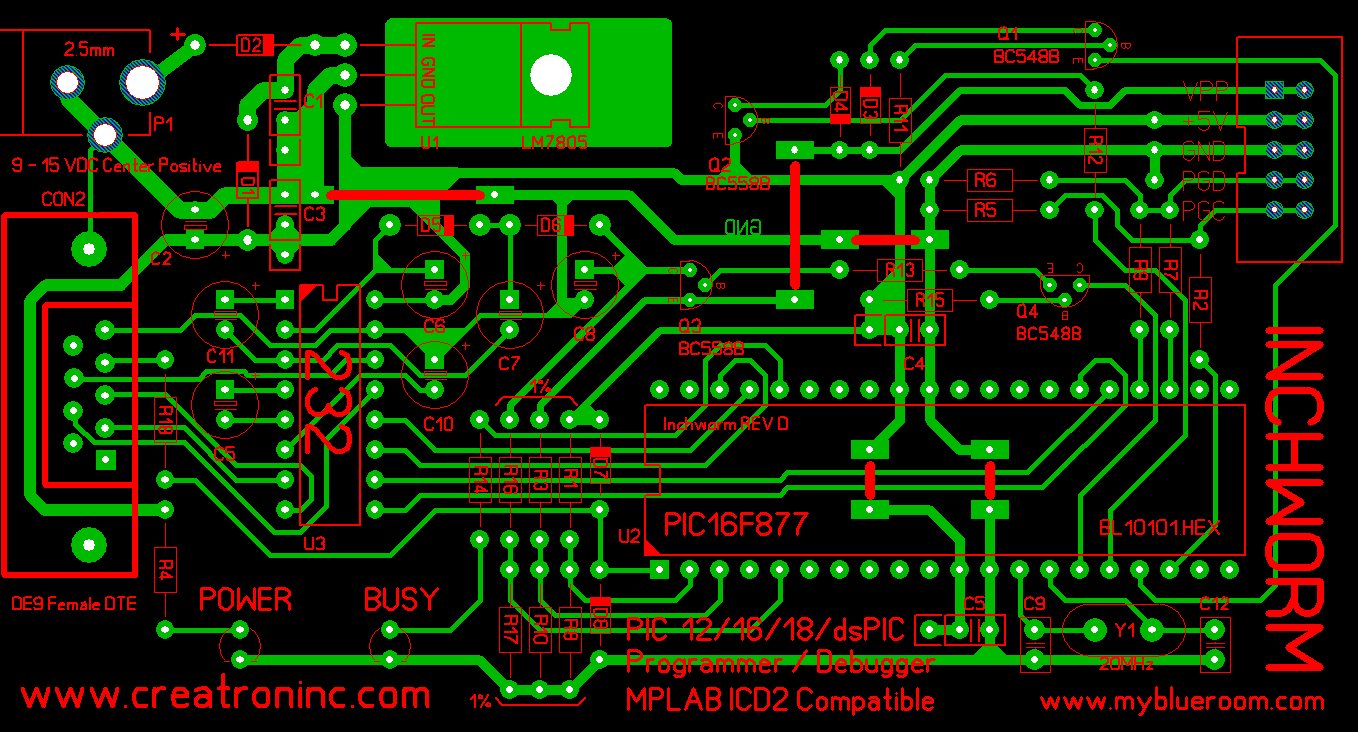

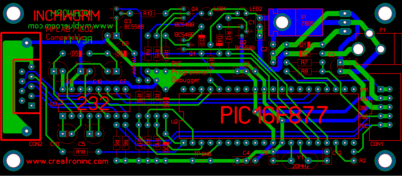

Just finished my first PCB layout. Not sure what to export in the Gerber plot and drill data. Heres the schematic & layout. What is the proper method to post a PCB layout?

Looks nice Bill.
Why are you usin' that big '877 instead of an '876 or '876A? You can come up with a much smaller board using an '876/A (I also install 1/8th watt resister A2D dividers and MAX232A 100-nf caps in the open area of the machined sockets underneath the ICs).

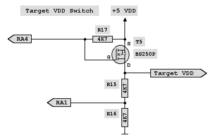

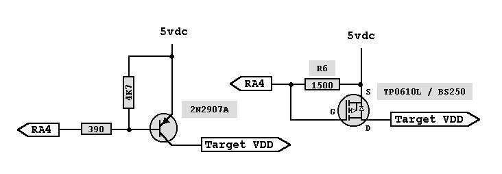

Why are you omitting Target VDD switching capability? Are you sure you're never going to use VDD coming from the target board?

Hi Mike, always good to hear from you.
Answers:
The 16F877 is in easy supply here in Toronto, it's also useable in the USB 18F4550 version of the ICD2 (very fast) I've got the 18F4550 but can figure out what firmware or driver to use when I connect it.
You can power the programmer from your target, I've got the diodes across the 7805 so you wont damage it.
As for stuffing bits under the CPU (inside the socket) next time, I do it all the time; not sure if it's standard practice.
The bigger caps give it the power it needs, after looking through the maxim voltage doubler app notes. The cheap max232 parts work best. It appears to be faster than my PICStart Plus...
I love those baby caps, I'm trying to get the local retailers to stock 10s & 1s I can get 4.7s though.
I wonder if a 20MHz resonator would work?

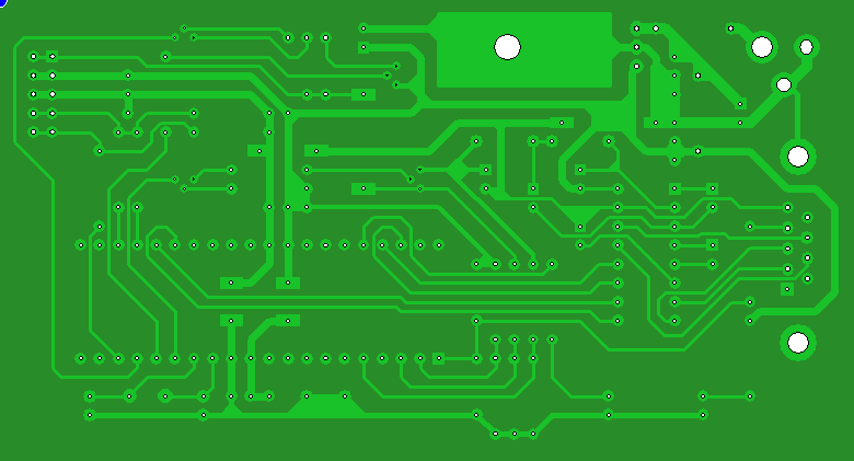

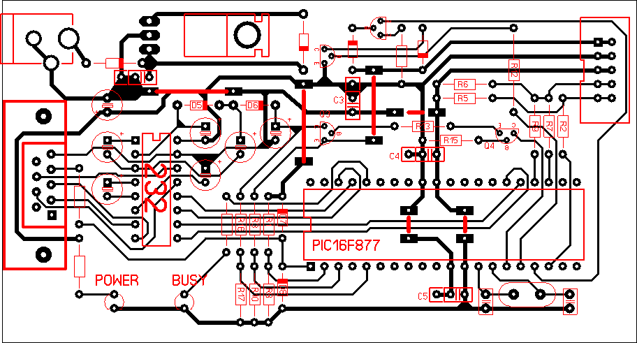

Just as a challenge I've redrawn my Inchworm ICD2 clone to a single sided PCB. It's 115mm x 62mm
I've got to double check the layout so DON'T make one yet.
I'll try to etch it myself to test.
Seems single sided PCBs are very cheap compared to multilayer.

Forgot to answer this before.
Target VDD switching is not a mechanism for powering the ICD2 from VDD on the Target board. Rather, it's an option to power the Target board with VDD from the ICD2. You have VDD from the ICD2 hardwired to the Target board in your circuit, which is the same way Lothar did it in his design.
I included the Target VDD switching circuitry in my design because I mistakenly thought the ICD2 might be 'smart' enough to power up and power down the target board and use "vpp first" and "vdd first" methods for placing the target device into high-voltage program verify mode but I was wrong. It seems VDD is "always on" wether you use ICD2 controlled target VDD switching or a hardwired scheme. So, I suspect there probably isn't really any advantage to ICD2 controlled Target VDD switching.
Regards, Mike

Yes it's a real very basic compatible, it's about as simple as I could design it based on Lothars design. It's works and works well. As a programmer it's fast and supports scads of PICs, as a debugger it can be slow but better than nothing...
I've used the transistor outputs as they don't require the higher voltage that Lothars LM358 version. I've also made it so you can power it from your projects 5V. (The VPP is generated by the MAX232 with some big 10uf caps) I've used the TI 232 (cheap) and it works fine with the 10uf, I'll drop in different chips to test. You could probably use smaller caps like 4.7uf if you don't have 10uf, the filter cap should keep ripple low.
The Microchip ICD2 has many more features like USB, programmable VPP power and switched power. Buffered I/O etc.
When used with MPLABs BL10101.HEX it behaves like the real thing, it will download new firmware as needed.

I've attached a picture of the single sided version, I'll post the Gerber & drill data on my site in the next day or two. Just tweeking it.

I will see if Eagle will import gerber. Or if you have you a trace version without the parts overlayed, I can size it in photoshop and print to paper and etch it..

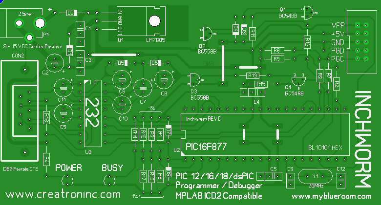

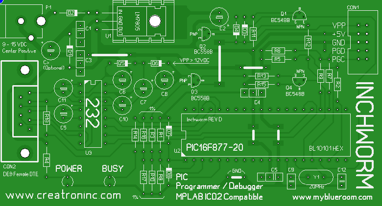

Here's the final (at least it's the one for the first run of PCBs)
I'm just updating **broken link removed** and adding a link with the Gerber & Drill info.
