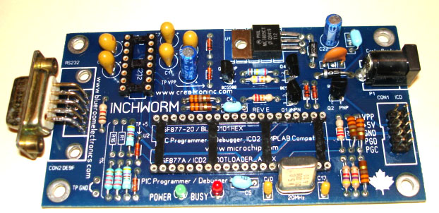

Bill: all but two resistors (6K8 1%) and plugging in the two chips (and power). Here is a picture. I found an RS232 connector. Used, solder all over it. But it will work. :D
Nice gold sockets, glad I put both .1 & .2 spacing for the decoupling caps.
You're almost done...
You could plug it in now and test VPP (shoud be 12V or thereabouts)

Did not look to see what the 6K8s went to, but if 1% assume it should be the real deal.
On the cap spacing, I still had to work the ones for the Xtal. But that was a great idea. Old parts I had around. :) But two R's and done. Now I have to justify something from mouser and stick the two resistors on the order. :D
