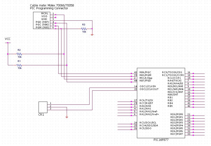

hi everyone, hope you can help me. at school i was given a general control board which includes an fpga (lattice) and a pic device. i am trying to read the code of the pic, but the programming male connector (the one that goes on the board) has pin 2 (Vdd) missing. i have tried several ways to connect everything so that i can read the code from the pic. but nothing seems to work. is there any way to connect things so that i can read the pic? because these two devices belong to an even bigger circuit and it would be quite complicated to remove the pic just to read it.

the device is a PIC16F877. when i connect the mplab icd2 via usb and power the target (it needs 24V the general board) this is what appears:
Connecting to MPLAB ICD 2
...Connected
Setting Vdd source to target
ICDWarn0020: Invalid target device id (expected=0x4D, read=0x0)
...Reading ICD Product ID
Running ICD Self Test
... Failed Self Test. See ICD2 Settings (status tab) for details.
MPLAB ICD 2 Ready
i'm assuming that it has something to do with the pin that's missing, the vdd one. and on the power settings:
target vdd: 0.00
target vpp: 12.46
mplab icd 2 vpp: 12.46
also, i have selected the option "target has it's own power"
Can you post the circuit of the target board, or at least that around the MCLR and programming pins?.
It's quite possible that you need to do something (such as remove components, or short pins together) to allow access to the PIC.
hi, sorry for answering so late. this is the schematic of the board's connector. the VCC is the one that gives power to the entire board (not just the pic device) and it's 24V, the CR1 is a ceramic resonator. if you need anymore information please let me know. thank for your help
I'f you have an original ICD2 like me you must take out the 10K res. pull up from the PGD line.
When running in debug mode you don't need the 10K pull up on MCLR, the ICD2 does the work.
The ICD2 has internal 4,7K res. that will do the pull up/down when needed.
About PGM, i think that PGM is only used for low voltage programming... So don't connect it. (unsure on this)
About the Vdd from the ICD2, dispite what others may say, you must connected it to your target device, use a diode to prevent the ICD2 from powering your device, the reason is that the ICD2 uses a buffer on the outputs, this way it can work on any voltage level and with any PIC !!!
You can keep the MCLR pull up it does no harm, but that way your device is allways working, even when it isn't on debug/running mode on the MPLAB... It enter programming state an reset state but after that it starts running because it allways has 5V on it...
Have fun!
hi everyone, problem solved! i connected a wire from the pic's vdd pin to the connector's vdd and it worked. it was kind of a desperate measure, but it worked. now i have another problem hahaha i extracted an hex file from the pic's memory (which i converted to asm, and doing the best to understand how it works) but i don't know where to get information regarding pin configuration. on the hex file i extracted from the pic it doesn't appear...
