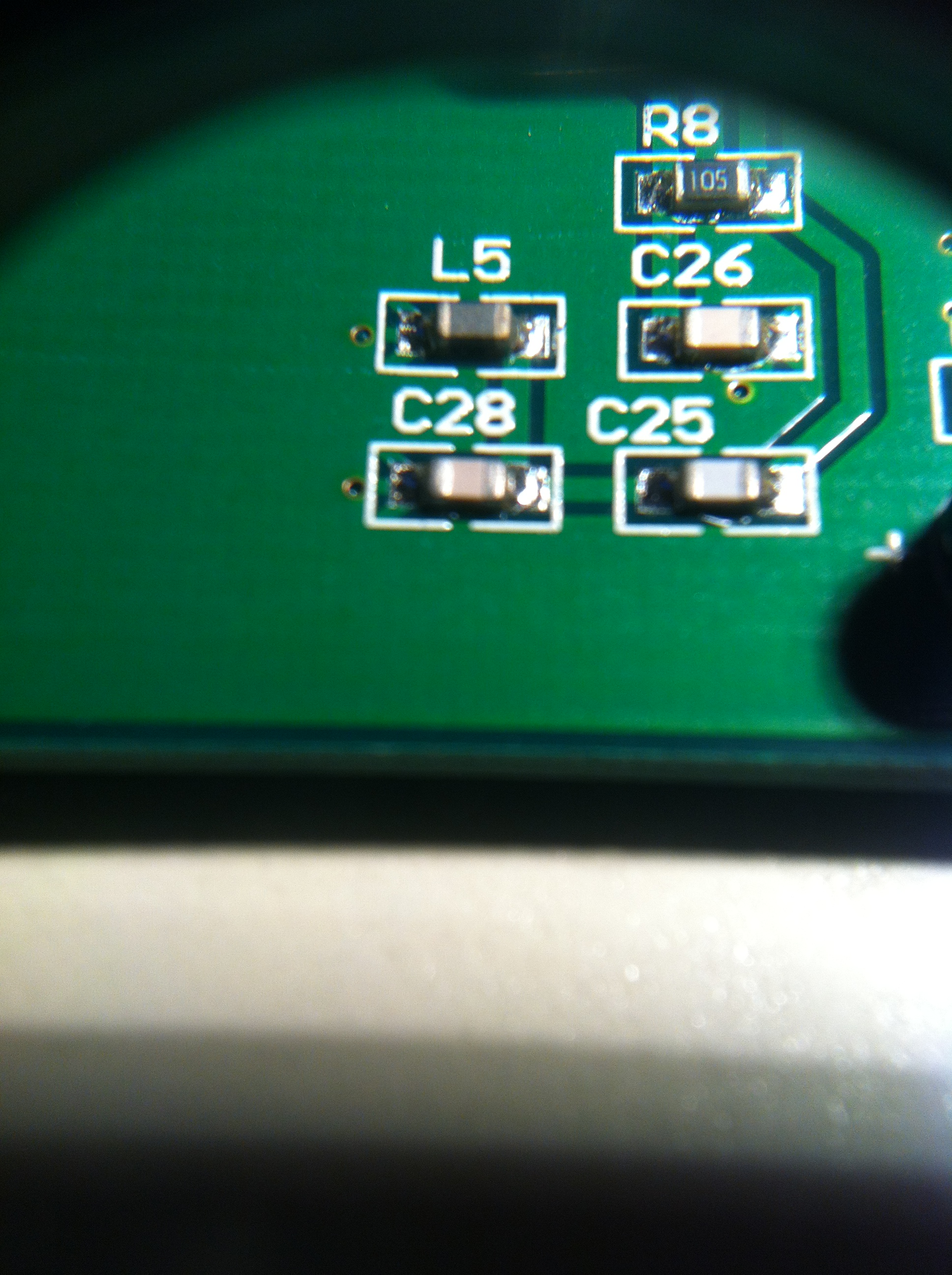

What is the black smd device on a circuit board with 000 on the top?
Can they pop off in lightning comes in on a dvr card?
All I have is the two empty solder points left on two dvr cards.

I would guess that L5 is an inductor. Can you unsolder a good one and measure it or read the numbers on a good device?
Here is the picture of L5. Note the lack of solder on the right side. Maybe it was not soldered down right.
010-jpg.113398

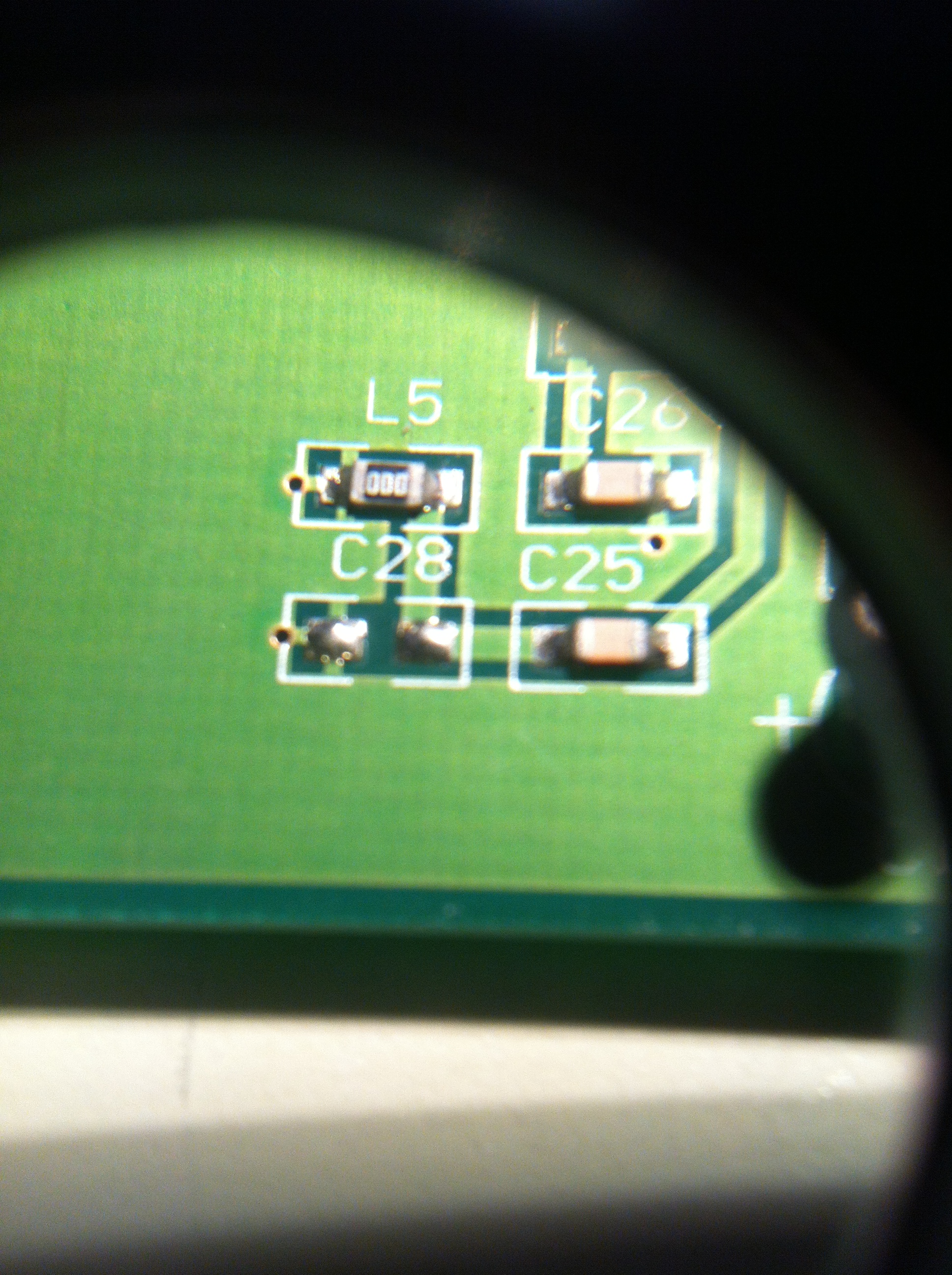

L5 with 000 on it was a 0 ohm resistor, also known as a jumper.
The component at L5 in the first picture is not the same as the 000 component at L5 in the second picture. In the first picture, "L5" has thickness; it's not thin like a resistor or 0 ohm jumper.

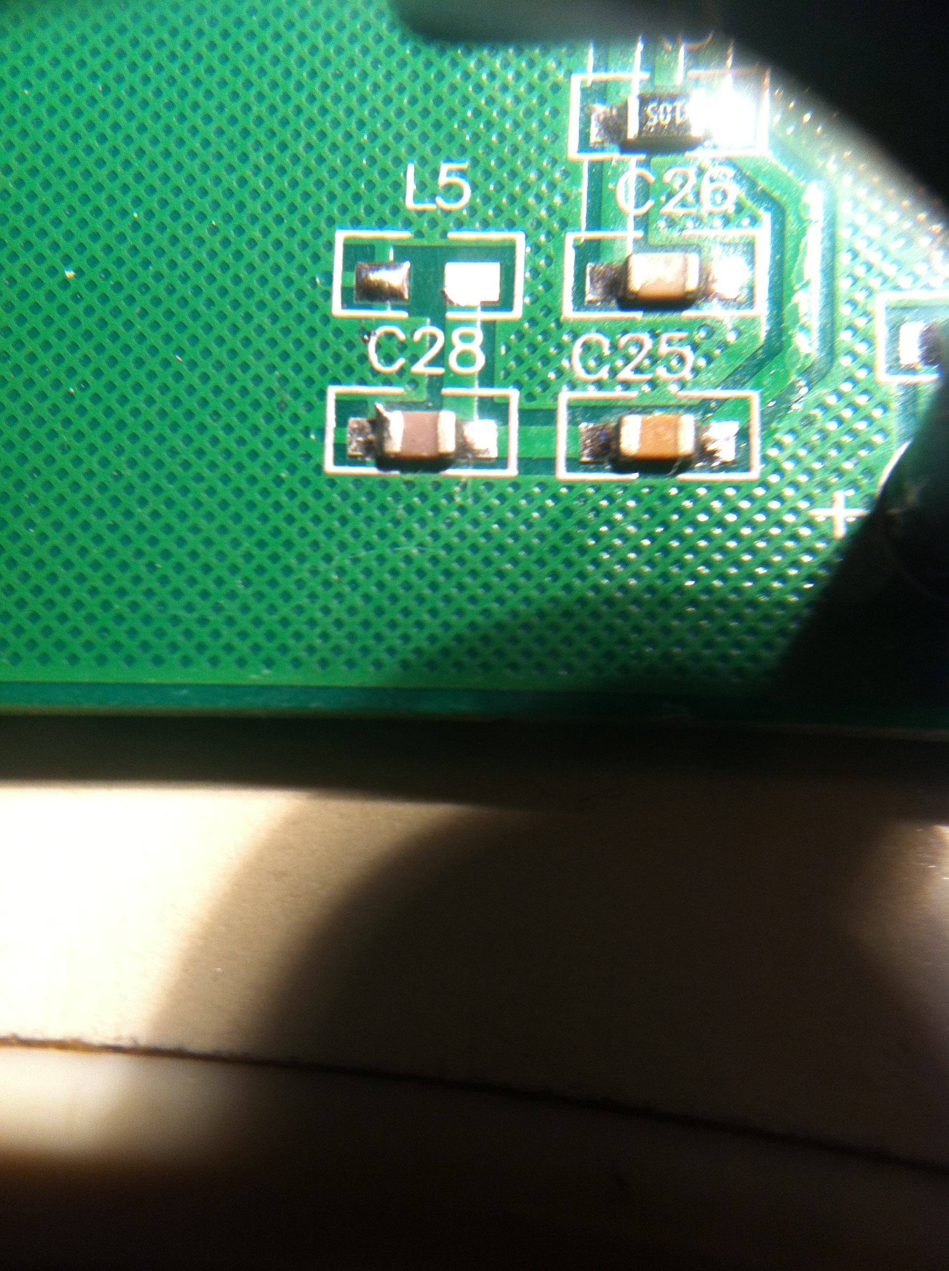

If lightning made them 'pop off' there would be a LOT of visible damage, and 'blast marks' where the resistors were. The unit would also be toast!.
If the components aren't there, they were either never fitted (often boards are designed for various uses, and unused components aren't fitted in specific versions), or someone has removed them.
In Ron's enlarged picture (Post #3) of that section of the PCB, IMO, rather than there being no solder on the L5 RH pad, it appears to be over-exposed and the same result can be seen at C26 + the resistor above.
Unless there is evidence of a component being there previously, such as remnants or an impression in the remaining solder, pads with a smooth blob of solder were more likely to have never been populated.

All three shots are three different dvr cards. the pic with both L5 and C28 devices in place are on a totally bad card.
The second pic is a dvr card with camera port 1 open now. The last pic is another dvr card with camera 4 port open now.
All three cards went bad after bad storms came through the area.
The two card with missing a smd still work but only has 3 good camera ports now.

L5 was most likely originally intended to be a ferrite chip, its purpose to suppress noise coming in on the trace. They are effectively inductors, hence the "L" designator prefix. Sometimes after design and testing they are deemed unnecessary and are replaced with 0 ohm (jumper) resistors during assembly. I am willing to bet that is exactly what happened in this particular case. You can probably replace it with another 0 ohm resistor and not have a problem.

If the solder is smooth on the pads, then the component was most likely never installed. Leave it unpopulated.
That brings me back to my other post, The other 10 identical vdr cards have both L5 and C28 connected with a smd so I thought these two dvr cards, which they are all identical cards, the smds are missing.
All the other identical cards are bad due to storm power surge have L5 and C28 populated. These two have missing parts compared to the other 10.
All the other cards failed to work at all. The two cards with missing parts in question do work. The problem with each card is now they each have a camera port open. One card has camera port 1 open the other card has camera port 4 open.
When I replace the smd in a few days I'll know if anything is different.
Good News!
I changed the L5 SMD today and the DVR card works again.
I pulled a similar smd off another bad card and put in L5.
I guess that means it must have popped off during a storm. The L5 location in Pic #10 shows solder only on one spot. The other spot looks pristine as if it never had a smd there. I had no other option but to try.
