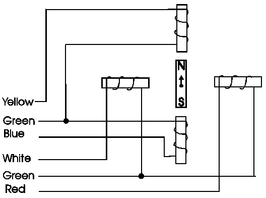

Well, I'm not realy looking for an ID on the motor. I'm actually wondering what type of brushless motor has 7 wires coming out of it. Or is this more of a stepper motor? It's advertised as a brushless motor.
One other thing that might help narrow down what it really is...the RC servo motors are tiny- they have somehow found a way to squeeze all the drive electronics, whatever they are into that space.
Most (all?) stepper motors are brushless, I've never seen one used in a servo but that sure looks like one. I bet that thing has a beastly amount of holding torque. I'm guessing it's a 6 wire stepper with a 7th for an internal tach/decoder?
You'd think so wouldn't you? But no, the torque on that servo motor is spec'd quite in line with other brushed servos.
So you mean a stepper like the attached schematic? Does it matter whether common green wire is tied to +V or ground? I don't think it does because it just means you commutate in the opposite direction. Connecting common to +V would make it really convenient since you could just use low-level NMOS for everything. THen it would be even simpler than an H-bridge for a brushed motor.

I've tied steppers to V+ before for the same reason, there's no reason not to as long as the case isn't 'grounded'. Using meter on continuity should help you figure out which wires are which coils, depends on what that 7th wire actually is though. You'll find a single resistance for each coil, if you get double that resistance you know you're measuring continuity across two coils.
I just took a closer look at that picture, it looks like it has 8 wires? 8 wire steppers are just two wires per coil and can be simplified by tieing all the commons together and using it like a 5 wire stepper, would seem silly to put a tach on a servo drive cause they're usually direct read from a pot attached to the output shaft.

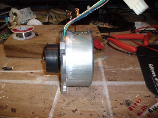

I have a big dc brushless servos it has 9 wires I was hoping you
I was just curious...these servos are too expensive right now for me to open up and gut.
:D so maybe I wouldn't have to :D i been trying to see how it worked I have the controller board for it.
