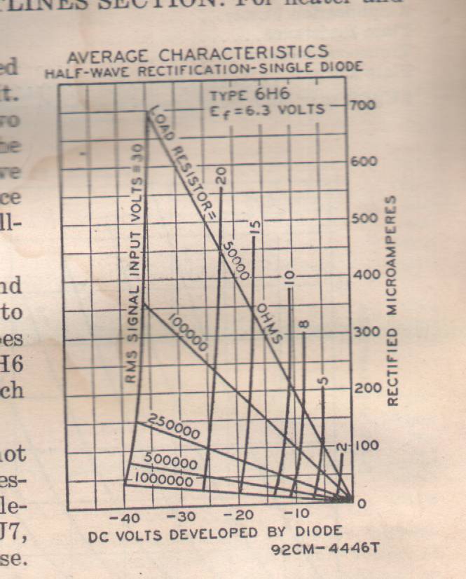

Attached is a the characteristic of an Ideal Diode. Will you call it "time invariant linearity" ? I think yes.
X axis : Voltage
Y axis : Current
Can anyone explain me the graph.
The X and Y axis is the same as diode characteristics.
What is a dual diode?
And why is the voltage negetive? and the sloping line that says RMS ?
I have never seen a characteristic like this.!! :shock:
Welcome to valves :lol:
But what exactly are you trying to do?.
The intersection of the RMS input line and the resistance load line gives the output voltage and current. For example, 20 VRMS input and 50,000 ohms intersect at 22.5 volts output and 450 uA current. This particular dual diode has two plates and one cathode, which is typical of most tube (valve) rectifiers.

As in my first post, I was just wonderinf if an ideal diode shall demodulate AM signals? And the Ideal Diode chacteristics as I belive, is posted above.
And about the valve picture - I guess that X-axis is the DC voltage the Y-axis is the Current (DC ?) and the characteristics also shows AC characteristics (the sloping lines)
But the title says that it is about a half wave rectified output. So everything should be RMS and the input should be AC. In this case what is the DC voltage developed by the diode(X-Axis)?
A diode, ideal or otherwise, passes current in only one direction, so if AC is applied, the output is DC. The current can be collected in a capacitor which will provide a peak voltage at no load. In order to demodulate an AM signal, the capacitor must have a load that will discharge the cap as fast as the highest frequency that is to be recovered.
okay... I think I got it...
I was thinking that there is no voltage change when the diode is forward biased there might be no signal....
I just realised that the graph(The one I posted.) showed the voltage drop across the diode and the signal would be developed as the voltage drop across the load resistor.
