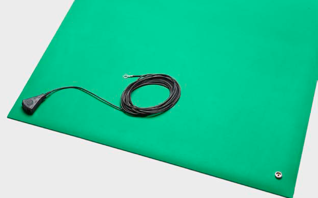

You should be working with the circuits on an ESD mat and then all you really need to do is connect your ground-strap to the mat. If you always connect the ground-strap to yourself before touching the circuits you will be safe, since you will be at equilibrium with the ESD mat and any circuits on the mat. Having the mat or yourself absolutely at earth ground potential is not really a necessity.
If you have the mat you wouldn't need a wrist band you'd just place your hands on an unused portion of the mat, keep in mind the mat itself still needs a connection to ground. A wrist band would still use the resistor, but it would be tied to the common ground the mat shared, not to the mat itself.
The mat you linked to would likely be fine. Most of the ESD work mats I have worked with are like the attached image. They have snap connections. The point where the mat connects to ground uses a snap connector with a few banana jack connections for the wrist strap. This wire is a straight shot to earth ground. There is no resistor in the mat connection to ground.
What I did not see in the 1mm thick mat you linked to was a connection point. Like I mentioned, generally a snap connection. While ESD mats can vary quite a bit depending on the work-scope I don't see it as a big deal for home use.
Ron

That's interesting. Can I buy this item: https://www.elfa.se/elfa3~eu_en/elfa/init.do?item=80-081-79&toc=18875 and ground myself to it with a 1Mohm resistance wristband, and all will be well?
Is that correct?
Well, others disagree with me but I believe that should be fine. Since that mat normally has a relatively high resistance so you don't need the 1 meg resistor but it won't hurt. The objective is to keep you and the circuits you are working on at the same potential, which connecting the wrist strap to the mat will do. It's nice to also keep the mat at earth ground potential but that's not a necessity as long as you and the mat are at the same potential. There's nothing magical about "earth ground".
The may is mostly for placing the parts on when you're not handling them. If you intent to pick up the parts and do something with them, you should be wearing a ground strap. The may is useless once you lift a part off of it. You wrist strap and the ground to the mat are usually at the same point. There should be a bananna connector that snaps to the mat with receptors for both the wrist strap and the ground wire.
Ron
How can it be safe to ground the mat without a resistor?M
If you look back to your mat specifications you will see: Surface resistance 100 kΩ. So while the work mat is conductive it isn't like a straight piece of wire or placing your work on a conductive metal surface. That number is also based on a point to point distance and a specific weight or force on the mat covering a defined area. So the mat has plenty of resistance. There are volumes of text and specifications written on this stuff but real quick:
ESD Mat is made of high density closed cell expanded Polyvinyl Chloride material. These ESD mats are resistant to degradation by inorganic acids, detergent solutions, alcohols, mineral oils. Surface resistivity is is 10^9 – 10^10. Service temperature of -20oF to 160oF. Meets ASTM D412, D624, D2240 and ESD S4.1-1997 standards.
There you have it and why the mat does not require an external resistor.
