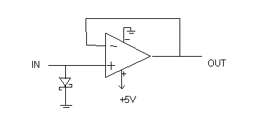

Please tell me if this would work as a half-wave rectifier for a 1Vpp bipolar square wave. Would the capacitance of the schottky diode interfere with the reading? I need to find out the peak value of the input signal.
Sorry for the mspaint drawing but i wasn't able to find schottky diodes in orcad (I'm using a 1N5819 or 1N5711)
Thanks.

Thanks for the respose but the problem is protecting the opamp input from reverse voltages in excess of -0.3V (the maximum for single supply according to the datasheet), that's why that diode is there, and I think I've put it in the wrong direction (I want to clip the negative side of the waveform)...
I need to know if it can hold out indefinitely, given that I'm driving the opamp with some reverse voltage.
Yes, to clip negative voltages you need the diode anode to ground. Also add a resistor in series with the input to limit the current, 10kΩ or so.
The diode capacitance should not be a problem unless the frequency is high. What is the maximum operating frequency?
1KHz but the signal is a square wave and I need to have a somewhat precise measurement of the peak voltage. The filtering cap lowers it a bit but I can compensate for that.

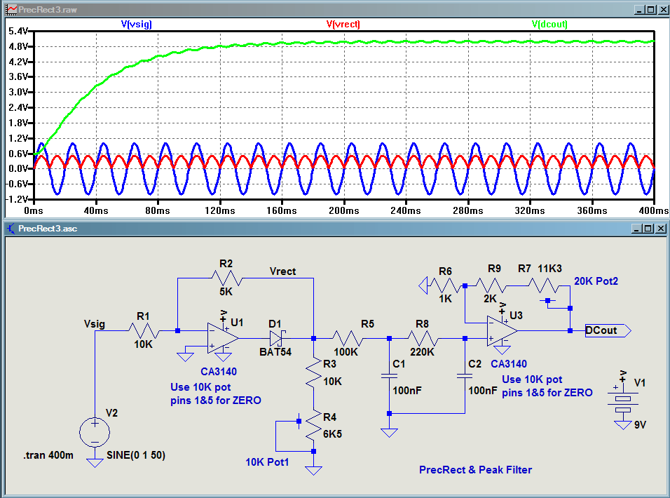

Have a look at this option.:)
For a 5V supply you should get about +3Vout,, use a Vref of +3V on the PICs adc.

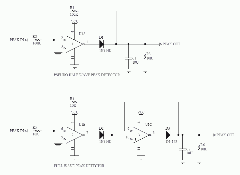

If you use the op amp as an inverting amp, the negative input becomes positive at the opamp output. Also, a positive input signal stays positive (due to the diode being reverse-biased). So no negative supply is needed. Also, neither input will be dragged below zero volts, so the opamp is happy:)
Have a look at the attached cct. The single opamp inverts a negative signal and charges the cap if the input signal magnitude is greater than the voltage on the cap (just like a perfect diode). When the input is positive, it has little effect on the cap (200k charging/discharging the cap). Therefore it's basically a half-wave rectifier.
The 2 opamp cct has a similar rectifier cct but the output is buffered by a precision diode. So now both +ve & -ve parts of the input are used to update the value on the capacitor.
Enjoy!
Enjoy!
Well... that seems to do the job but I can't quite grasp the fact that the negative input of the opamp becomes positive... From the simulation I've run it seems that way, with a spike of negative voltage in front of it (perhaps just before the feedback loop works its magic). Will this damage the opamp in any way?
@ericgibbs: Thanks, but I think that design is a little too complicated for me :) I need something simple which I can fully understand, if the teacher decides to ask questions.
The opamp is configured as an inverting amplifier. So the opamp output voltage, for a negative input will be positive. The output voltage will be such that the voltage at the negative input - the junstion of the resistor divider - will be 0V (i.e. the same as the +ve input).
When the input goes positive, the output of the opamp tries to go negative, but it's limited by the negative supply of the opamp - which is 0 volts. The diode is also reverse biased in this scenario.
If you were to use a negative supply rail for the opamp, when the input went positive, the opamp output would go to the negative rail. This is because the diode is reverse biased, and therefore there is no negative feedback for the opamp; the gain becomes huge. Try simulating the circuit with a negative rail on the opamp; you'll see the large swing just mentioned.

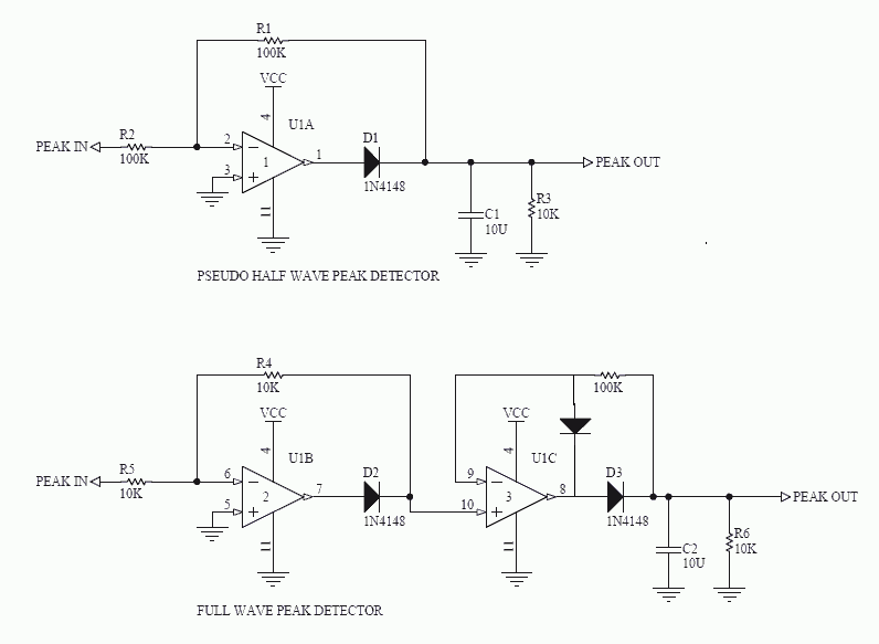

Any negative voltage will be an artifact of the simulation software I would think. There will be a delay for the peak detector due to the opamp having to jump from 0V to the peak voltage+0.7V (diode drop), especially for low slew rate opamps. You can reduce this with a extra diode and resistor (see attached). The extra diode stops the output from going more the 0.7V below the positive input. The extra resistor in the feedback path does degrade performance a little.
@ericgibbs: Ok, thanks. The rectifier is just a copy.
