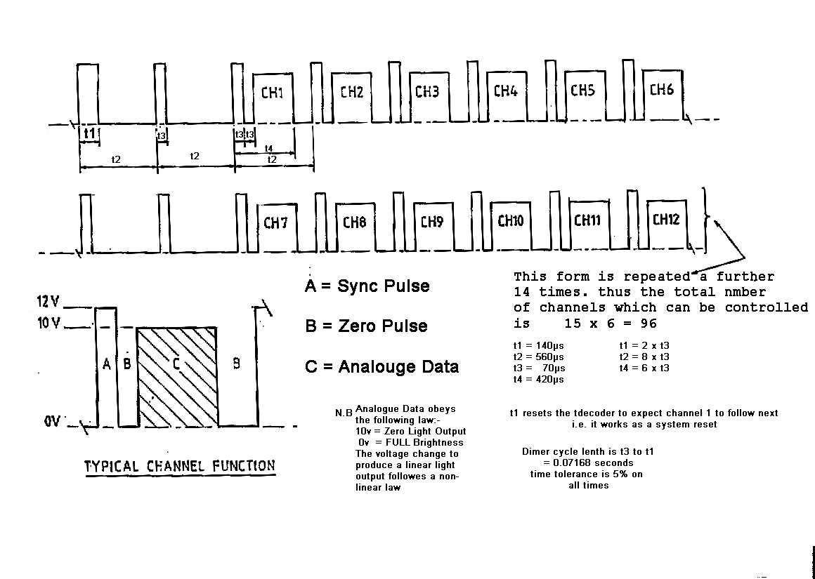

ideas needed, on how to generate this
henny
im looking for pointers on how to gererate the attached control siginal.
im thinking of going down the pic route but what to drive with the pic to get the desiered siginal
the control siginal is "Furse FMX" this is a muiltiplexed analoug control siginal for the control of furse lighting dimmers
the end plan is to make a converter that takes DMX512 and converts to FMX
any ieas would be great ,
cheers
henny

A brief look at the circuit reveals that two analogue voltages are needed. They are fixed +12V & 0-10V. The shortest timing is only 70us which is very comfortable for a PIC to work on. You can't generate the voltages using PIC alone but you can generate any voltage between 0-5V using a PIC with ease.
Then all you'll need is a voltage amplifier of gain 2.4X to amplify it into 12V.
